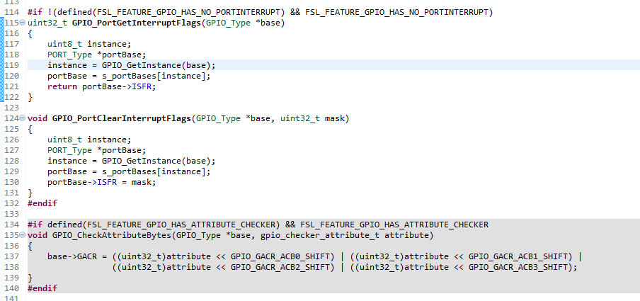

we use MK64FN1M0_VLQ12, KSDK 2.4.2
When I build Driver library out of KSKS 2.4.2 sources, two functions are excluded although they should be built.
GPIO_PortGetInterruptFlags() and GPIO_PortClearInterruptFlags() are excluded because in features header "MK64F12_features.h"  section "GPIO module features" a definition is missing.
MK64F12_features.h    (KSDK2.4.2)

/* @brief Has fast (single cycle) access capability via a dedicated memory region. */
#define FSL_FEATURE_GPIO_HAS_FAST_GPIO (0)
/* @brief Has port input disable register (PIDR). */
#define FSL_FEATURE_GPIO_HAS_INPUT_DISABLE (0)
/* @brief Has dedicated interrupt vector. */
#define FSL_FEATURE_GPIO_HAS_PORT_INTERRUPT_VECTOR (1)
// by MS
/* @brief set to 1 if device has no port interrupt */
#define FSL_FEATURE_GPIO_HAS_NO_PORTINTERRUPT (0)
Please check this and confirm my completion.

Hi Manfred:
I imported the gpio_input_interrupt demo into MCUXpresso IDE, the two functions are included. Please see the shadow of the code, excluded code is light grey. I would suggest you check the macro defines in your project.

Hi Daniel,
thank you for your answer.
I was wrong. I didn't realize the change from:
KSDK2.0                                        -->            KSDK2.4
GPIO_GetPinsInterruptFlags()       -->       GPIO_PortGetInterruptFlags()
GPIO_ClearPinsInterruptFlags()    -->       GPIO_PortClearInterruptFlags()
