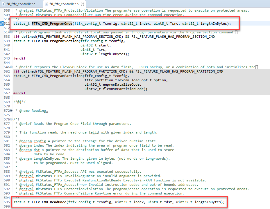

I'm moving my Software on Hardware K64 (MK64FN1M0_VLQ12) from KSDK 2.0 to KSDK 2.4.2,
We use the one time programmable memory to save MAC and Serialnumber,
Using KSDK 2.0 "fsl_flash.c":
status_t FLASH_ProgramOnce(flash_config_t *config, uint32_t index, uint32_t *src, uint32_t lengthInBytes);
status_t FLASH_ReadOnce(flash_config_t *config, uint32_t index, uint32_t *dst, uint32_t lengthInBytes);
In KSDK 2.4:
In documentation are both functions mentioned. But "fsl_flash.c" is not included in package 2.4
And "flash.h" is empty....
Can anyone explain this??
Manfred
2,539 Views
victorjimenez
Hello Manfred,
In the SDK 2.4.2 these two functions are located in the files fsl_ftfx_controller.c and fsl_ftfx_controller.h
Hope it helps!
