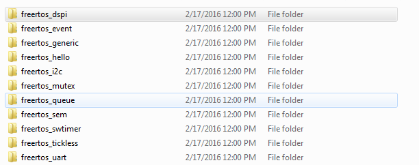

You  can download and install the KSDK2.0, after install , you can find the FreeRTOS demo
as these:

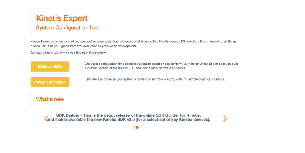

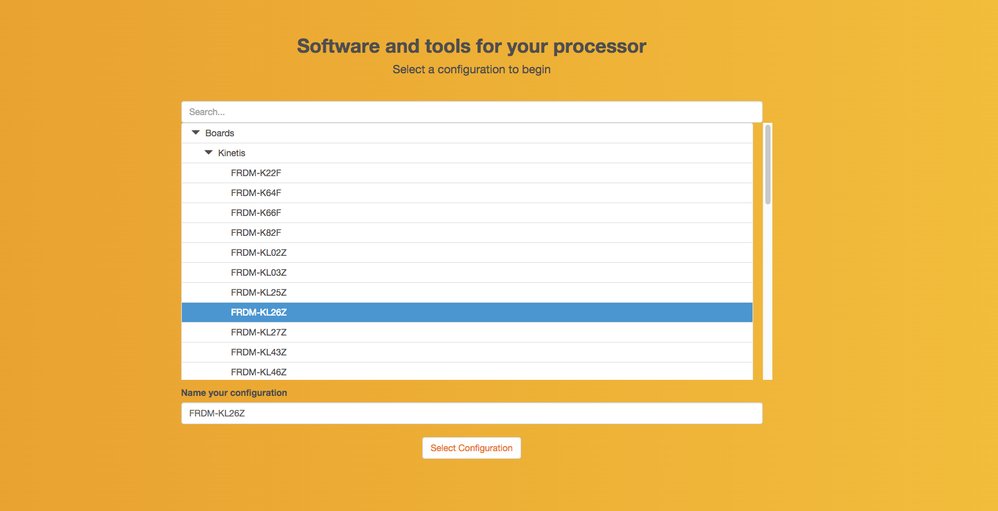

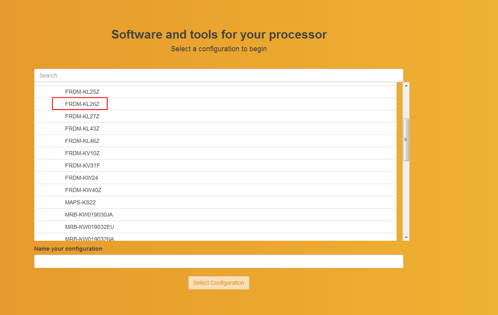

Hi,whenever I am pressing Select Configuration after selecting Board-FRDMKL26Z,its not moving forward and returns back to the same page without any error.I tried it randomly by selecting other boards too but  same is happening .

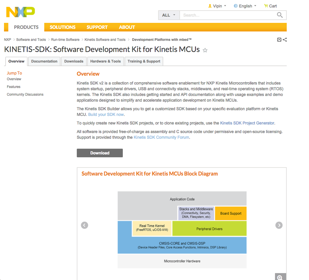

1st page-Download clicked.
2nd page-Kinetis SDK Builder Download clicked.
3rd page-Build an SDK clicked
4th page-Select Config after selecting FRDM KL26Z
5th page-the same page everytime not moving forward

Hi Vipin,
there are a lot of examples, but not all of them are for your board.
Please, take a look at demo I2C RTOS located under C:\Freescale\KSDK_1.3.0\examples\frdmkl26z\demo_apps\i2c_rtos\i2c_rtos_freertos
I hope this helps.
