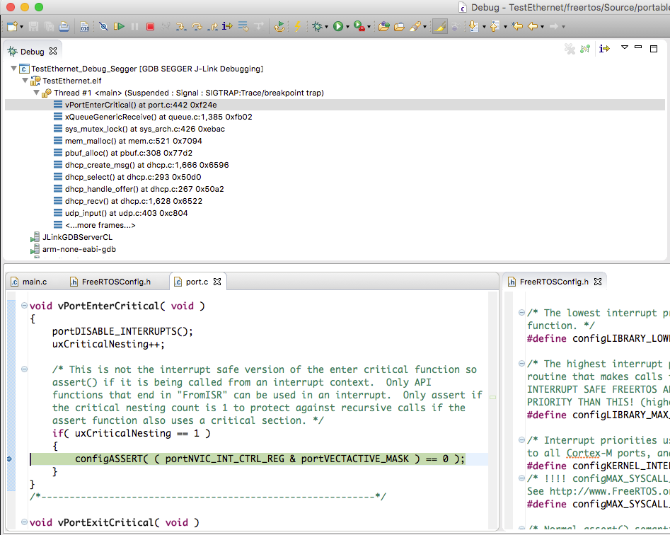

I have been trying for the last two days to integrate LwIP with KDSK 2.0. Unfortunately, with doubtful success. I just want to initialise the stack properly and retrieve an IP address via DHCP.
Whenever a packet is received (e.g. DHCP response from the router), the program gets stuck in one of the configAsserts(), either in xQueueGenericReceive or vPortEnterCritical().
The example project work perfectly and I can upload and debug them with the Segger OpenSDA v2 firmware. I tried to compare the files from the example projects with my own, but I couldn't find the mistake! I KDSK2 documentation is also pretty vage on how to integrate the lwip stack.
Here is the code: GitHub - dh1tw/BasicEthernet-K64F

      From your sceenshot and the code, the Ethernet frames are received by the receive interrupt handler. That mean when a Ethernet frame comes, the  ethernet_input->udp_input->dhcp_recv...->mem_alloc ... are all done in an interrupt context. However the sys_mutex_lock called in mem_alloc should not be used in an interrupt context.  Because the sys_mutex_lock will call vPortEnterCritical which will cause a ASSERT if it is called from an interrupt context. See more details in vPortEnterCritical in Port.c in freertos\source\.
Recommended solutions:
1.   Polling the Ethernet  Receive frames instead of calling by receive ISR.  So the receive frame will not be processed in an interrupt context.
changes should be done in ethernetif.c
2. If you prefer the interrupt context to receive the Ethernet frames, the ethernet_input should't be used as the netif input functions. changes must be done in this sentence " netif_add(&fsl_netif0, &fsl_netif0_ipaddr, &fsl_netif0_netmask, &fsl_netif0_gw, NULL, ethernetif_init, ethernet_input)" in main.c.
the tcpip_input (with LWIP_TCPIP_CORE_LOCKING_INPUT defined to 0) is a recommend input.
BTW, There are some issues in the main()
1. There is no tcp ip initialization in the main. the tcp ip init should be done there.
2. The vTaskDelay should not be called before vTaskStartScheduler.

For future reference - it would be really helpful if you could say *which* configASSERT() was failing, then I would at least be able to tell you what the symptom of the problem was, if not actually what the cause of the problem was.  Many of the asserts will have comments with further information too.  In this case it might simply be an interrupt priority problem, but without knowing which assert it was I can't be sure.
5,605件の閲覧回数
tobiaswellnitz
Hey Richard,
thanks for your reply! Find attached the debug screenshot where the program gets stuck (I presume in the moment it receives the DHCP response packet).

Thanks a lot for your hints, Meili!
Now everything works as expected!
I very much appreciate your explanations!
