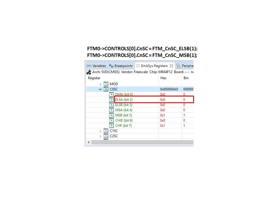

Hello Rong
I have additional question regarding to FTM PWM configuration
I’m trying to configure FTM registers using MK6412F.h “macros definitions” instead direct configuration (without macro) .
The only problem that I have is with FTM_CnSC register configuration.
When I use direct configuration there is channel #0, but when I use macro to configure FTM_CnSC channel #0 is not working.
I’m doing something wrong
For reference please see my source and EMSysRegister screen capture.
In register capture screen you can see tha

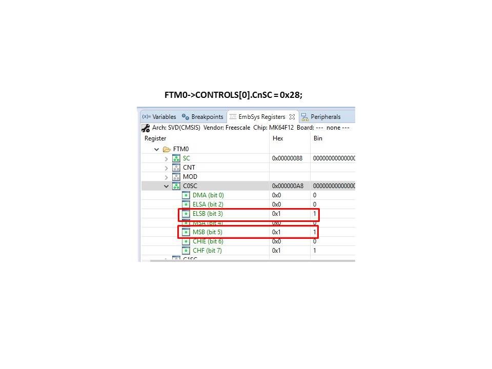

// FTM0->CONTROLS[0].CnSC = 0x28; //edge-alignment
/* +++++++++ problem +++++++ */
   FTM0->CONTROLS[0].CnSC = FTM_CnSC_ELSB(1);     // Not working
   FTM0->CONTROLS[0].CnSC = FTM_CnSC_MSB(1);         // Not working
   FTM0->CONTROLS[1].CnSC = 0x28;

Shaul

Currently, pls   use    FTM0->CONTROLS[0].CnV=0x1000; to access the CnV register as a workaround.

In my project I want to change CnV (ftmParam[n].firstEdgeDelayPercent) during program runtime. Using percentage (%) is easier (of curse if the API SetupPwm in fsl_ftm.c will be corrected).

Although I do not know which register take effect on accessing the CnV registers, after a test foralong time, I found that it is okay if you put the writting CnV code at the end of for() loop. I modify the code here.
The code is correct for the branch    if ((mode == kFTM_EdgeAlignedPwm) || (mode == kFTM_CenterAlignedPwm)). The code is wrong for only "else" in the above condition.
Hope it can help you.
XiangJun Rong
