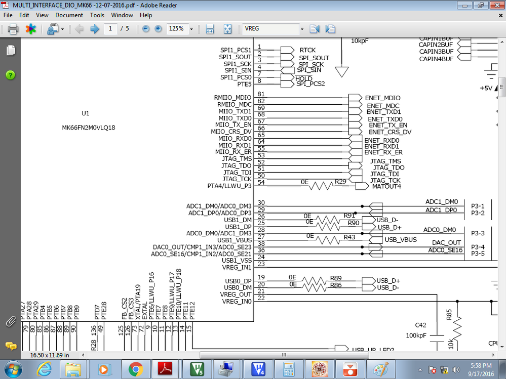

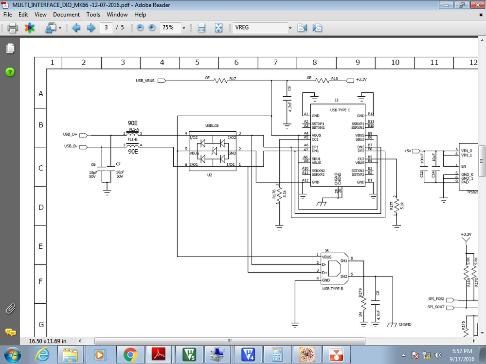

karthikas
Hai  xiangjun.rong
I am working with MK66FN2M0VLQ18 MCU in our customized board.for the USB device mode.(USB High speed mode).
I have downloaded SDK_2.0_MK66FN2M0xxx18 , and running USB_DEVICE_CDC_VCOM .
It was running upto APPTASK() without any problem , but It has stopped in APPTASK(), and device is not getting detected in PC.
Can anyone help me in resolving the issue as soon as possible.
Thank you.
6,721 Views

karthikas
Hai xiangjun.rong.,
Yes I have connected .
I am using USB1 ,
       USB1_DM --> D-
       USB1_DP --> D+
I am not using VBUS pin instead i am using on board voltage source.
I am attaching screenshots of USB part cir cute  for your reference. Can you please cross check once.USB_SCH.pngusb_sch1.png
