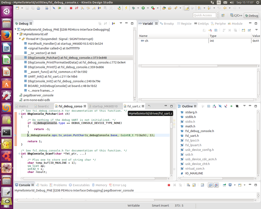

jlo1969
Hi David & Xiangjun,
Thanks for your help. I ordered the new TWR-K60D100M board to replace the old one (TWR-K60N512) and I just received it and I'm starting to use it now.
The good news is the code execution doesn't crash anymore when executing BOARD_BootClockRUN() function in HelloWorld (with FreeRTOS) application. Clock setup looks OK now.
Unfortunately, it crashes now during next initialization function BOARD_InitDebugConsole() when it tries to write a character on UART (DbgConsole_Putchar() function). I'm using the Tower System with the Serial Module (TWR-SER) and I would like to use the serial port as a trace port for my developments :-(
What is going wrong now using a sample application generated with the latest SDK2.0 (SDK_2.0_MK60DN512xxx10) on the latest TWR-K60D100M kit?
Thanks in advance for your help.
José

DavidS
Hi Jose,
I think the issue is the TWR-K60N512 is very old and first generation (Rev 1.x) of the K60 silicon.
The KSDK_v2 you built I believe is for the K60 Rev 2.x silicon and therefore builds but not run on the TWR-K60N512.
I would recommend getting the updated version of the K60 Tower kit which is the TWR-K60D100M (Rev 2.x silion) and it should work for you with the KSDK_v2.
