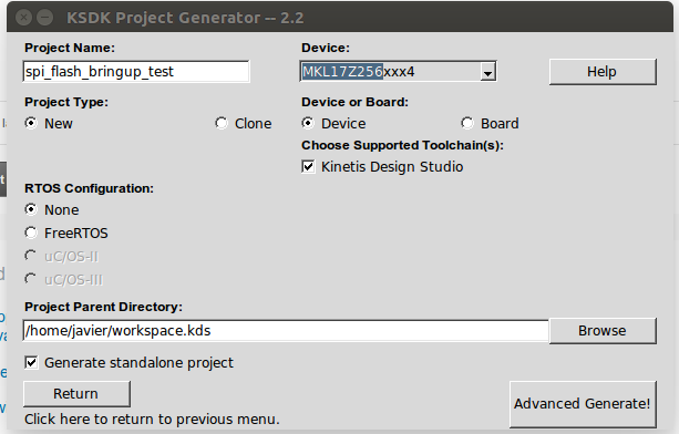

javiercardona
In other words, the only way to clone an SDK project in a directory outside of the SDK tree (for instance, in the workspace directory), is to create a standalone project (and select the parent directory to be the location where you want the project to live) and then move over the files from the SDK project you want to clone.  At least that is the only way I could get it to build.
This is because both the 'Generate standalone project' as well as the 'Project Parent Directory' controls are disabled for the 'Clone' type of projects.
Anyone has a better way to do this?

ZhangJennie
Hi Ted,
you can use KSDK project generator to clone a project for KSDK1.3.
Hope this helps.
Jennie Zhang

dereksnell
Hi Ted,
To further add some feedback, this discussion provides more details on why “Copy Projects into Workspace” causes build errors with KSDK examples: No Rule to Make Target error
Like David and Jamie already shared, you can use the KSDK Project Generator to clone a board, and then modify for your hardware without interfering with the original frdmkl03z board files.
9,542件の閲覧回数
DavidS
Hi Ted,
Copying to workspace in general is a pain and not recommended.
There is a project generation tool (it can copy projects too):
New Kinetis SDK Project Generator v2 is available!
I recommend using that tool and then import the project without copy to workspace.
David

jamiepacker
The Advanced settings for the project generator also allow you to create a "standalone" project. This creates a complete directory structure that you can copy to a different location - although you still can't use the "Copy into workspace" option because the standalone project still uses links to the files.
The other thing you can do with the new versions of KSDK is to create a custom version for just your taregt device and just the development system you are using. That make it much easier to have a working copy of the example sources that is only used by your project. So it won't break anything else when you make changes.
