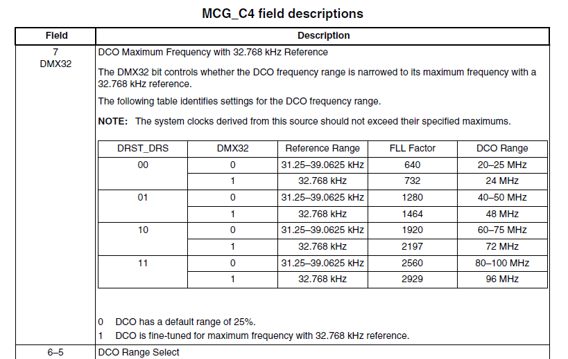

Regarding your question, I attach the MCG table.
95.9774MHz/0.032768MHz=2929
83.88MHz/0.032768MHz=2529
62.9MHz/0.032768MHz=1919
Do you use external precise 32.768KHz crystal and set DRST_DRS=11 and DMX32=1 to get 95.9774MHz clock?
I think the 83.88MHz is an expected clock frequency if you use default FEI mode and internal 32.768KHz IRC.
Hope it can give you clue?

xiangjun_rong
The configuration of DRST_DRS and DMX32 bits are different for high speed mode and normal speed mode.
For HighSpeed Run mode:
.mcgConfig =
            .mcg_mode = kMcgModeFEI, /*!< FEI mode */
            /* ------------------ MCGIRCCLK settings ---------------------- */
            .irclkEnable = true, /*!< MCGIRCLK enable */
            .irclkEnableInStop = false, /*!< MCGIRCLK enable in stop mode */
            .ircs = kMcgIrcSlow, /*!< Slow internal reference clock selected */
            .fcrdiv = 0U,
            /* -------------------- MCG FLL settings ---------------------- */
            .frdiv = 0, /*!< MCG_C1[FRDIV] */
            .drs = kMcgDcoRangeSelHigh, /*!< MCG_C4[DRST_DRS] */
            .dmx32 = kMcgDmx32Fine, /*!< MCG_C4[DMX32] */
            .oscsel = kMcgOscselOsc, /*!< Selects System Oscillator (OSCCLK) */
For normal speed run mode:
        .mcgConfig =
            .fcrdiv = 0U,
            .drs = kMcgDcoRangeSelMidHigh, /*!< MCG_C4[DRST_DRS] */
            .dmx32 = kMcgDmx32Default, /*!< MCG_C4[DMX32] */
Hope it can helkp you
