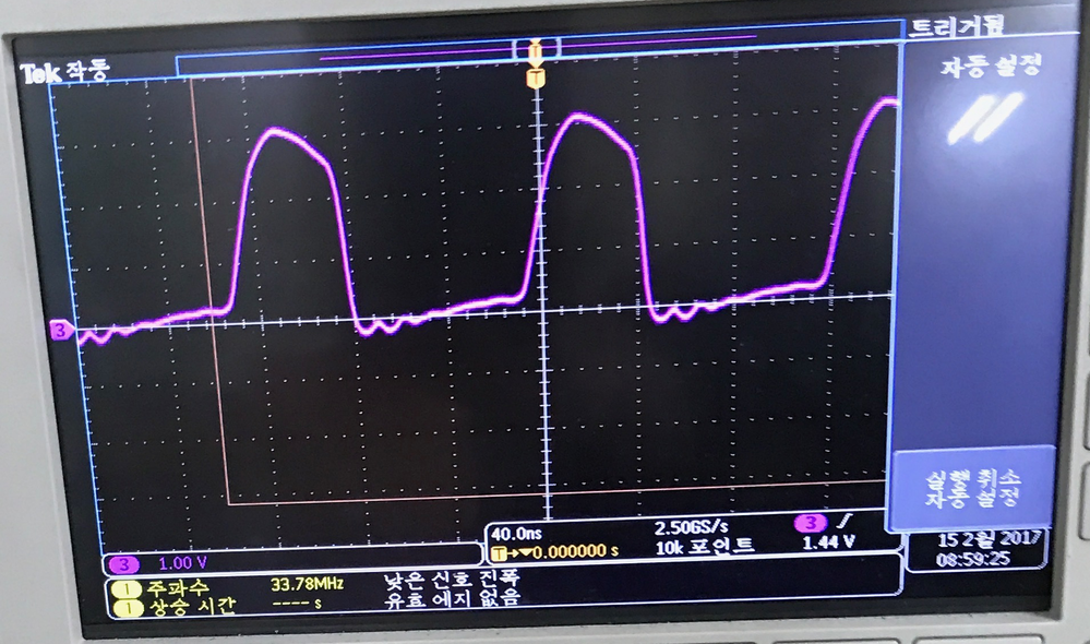

Clock is generated but it is not sine wave and wrong operation example code.
It is waveform from EXTAL0 pin.

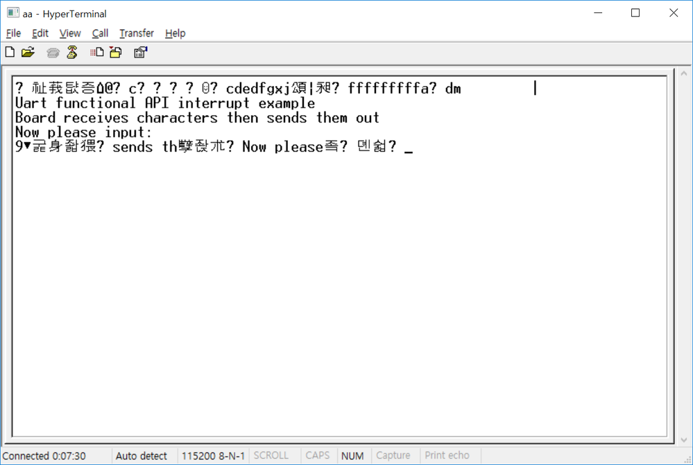

ther broken chracteristics of the uart interrupt example in SDK 2.1.

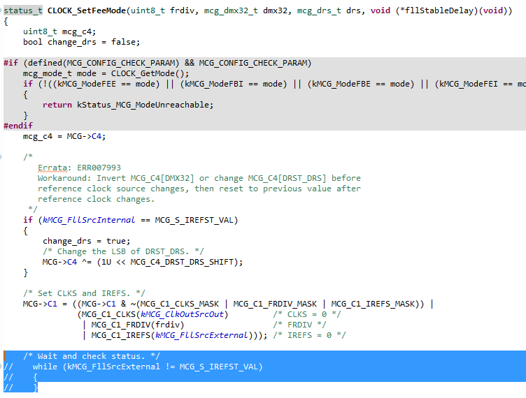

양승도
I generated the code from Clock Tool in your web site.
Even thought generating the code and X-tal hardware was verified with processorExpert in the past, it didn't work.
Now, it works after marking // some lines: wait and check status as following: I think it is not normal.
status_t CLOCK_SetFeeMode(...)
/* Wait and check status. */
//while(kMCG_FllSrcExternal != MCG_S_IREFST_VAL)

marek_neuzil
Hello Frank,
I have analyzed you source code and you have selected incorrect configuration of the OSC. When you connect external crystal you must select an external crystal mode and frequency range (and capacity if required). In your application the external reference clock is selected (EXTAL0 pin only is used).
See the following screenshot for details:
SDK 2.0 contains a defect - when FEE mode is selected and OSCERCLK is disabled the initialization code does not finished (a while loop does not finish due to an error). Enable OSCERCLK as a workaround for this issue.
