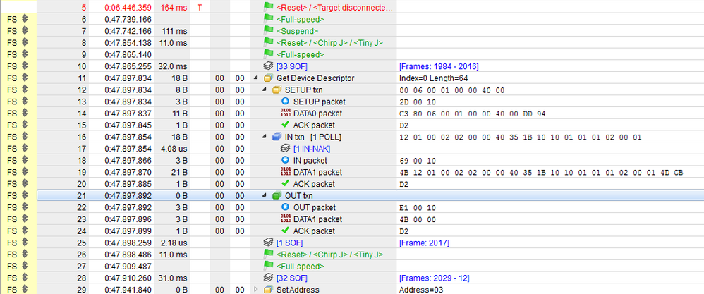

I can't get the dev_cdc_vcom_lite example from twrk21d50m to work on our hardware with MK22DN512. I tried running the version for frdmk64f and it works OK. Using USB snooper I see (for our system):
whereas for frdmk64f I see:
the code is virtually identical but our system does not send device descriptor. Any ideas?
thanks
