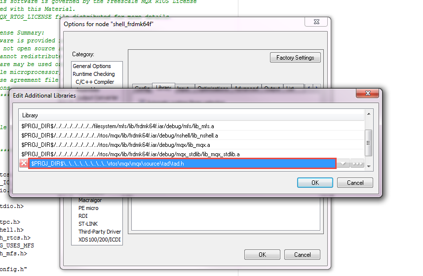

ivadorazinova
Hello Peter,
please, just for information, have you included to your project in IAR/KDS tad.h and do you have set path in linker?
I mean:
Thank you for your feedback!
Iva

peterfurey
Hello Iva,
I tried that and I still get the same error. Another thing that I've noticed is that TAD does not appear to be working with the shell_frdmk64f project either. When I try to list tasks after launching shell_frdm64f, it displays "Task list not retrieved successfully". MQX Task Queues displays "Task queues not installed!", MQX Stack Usage displays "Stack usage information not found!", etc.

peterfurey
Hello Iva,
Step 3 in the guide resolved my issue:
3. Open tad.c (located at /mqx_frdmk64f/MQX_Generic/tad/tad.c) and remove at the first line:
      #if MQX_USE_IO_OLD
and last line
       #endif // MQX_USE_IO_OLD
and included fio library
      #include <fio.h>
tad is now working in my shell task.
