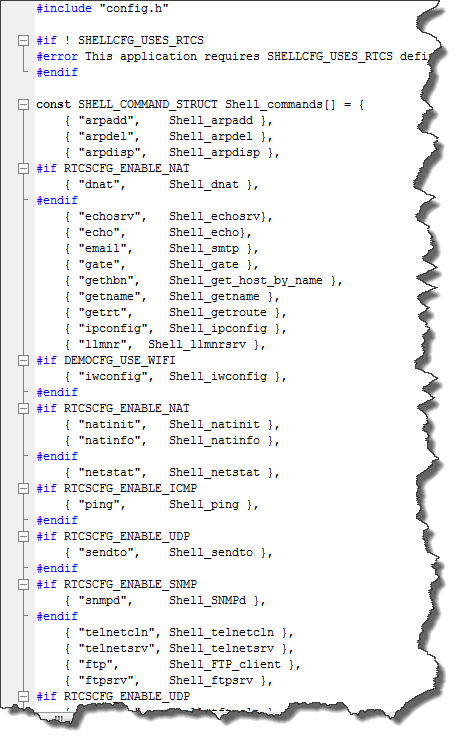

Please, have you tried demo for shell? The demo is located at C:\Freescale\KSDK_1.2.0\middleware\tcpip\rtcs\examples\shell\build\iar\shell_frdmk64f
In file demo_cmd.c are shell commands.
This file you can added to enable/disable commands (echo,copy,create,format......) to your project.
I hope it helps you,
Iva
