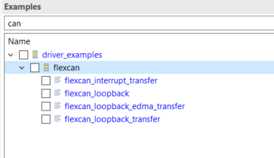

Hi friend,
We have a project that requires a CAN bus interface. I have installed the MCUXpresso IDE and have a FRDM-KW38 evaluation board. Now I want to generate an SDK sample. But I can't find the CAN bus project in driver_examples. I want to know which SDK example contains CAN bus procedure.
Thank you in advance.
Ted Wu

Hello @tedwu1
The FlexCAN module is a communication controller that implements CAN protocol. You can find some useful demo applications for this module in driver_examples > flexcan from the KW38 SDK.
Eduardo.
