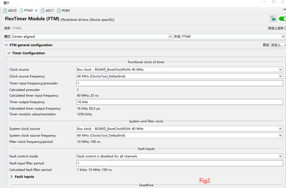

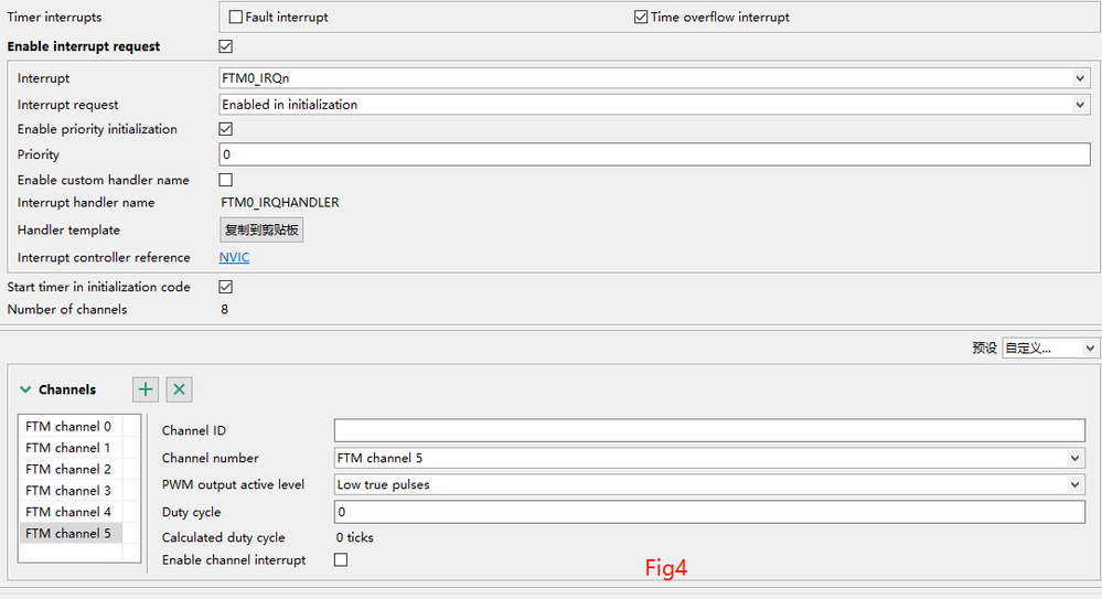

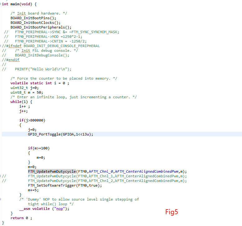

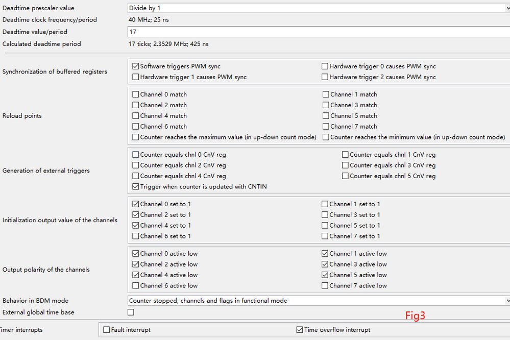

I want to generate 3 pairs of complementary PWM outputs. About my chip's (mk64)infomation and mcuxpresso IDE configuration [Fig1-4],please refer to the following pictures.

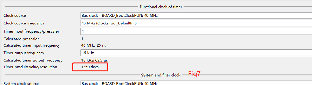

My confusion is that, the duty cycle measured by the oscilloscope is 50%,while the function"FTM_UpdatePwmDutycycle" input is 0 [Fig5-6].  I doubt that the time modulo value  is 2500 ticks [Fig7].
