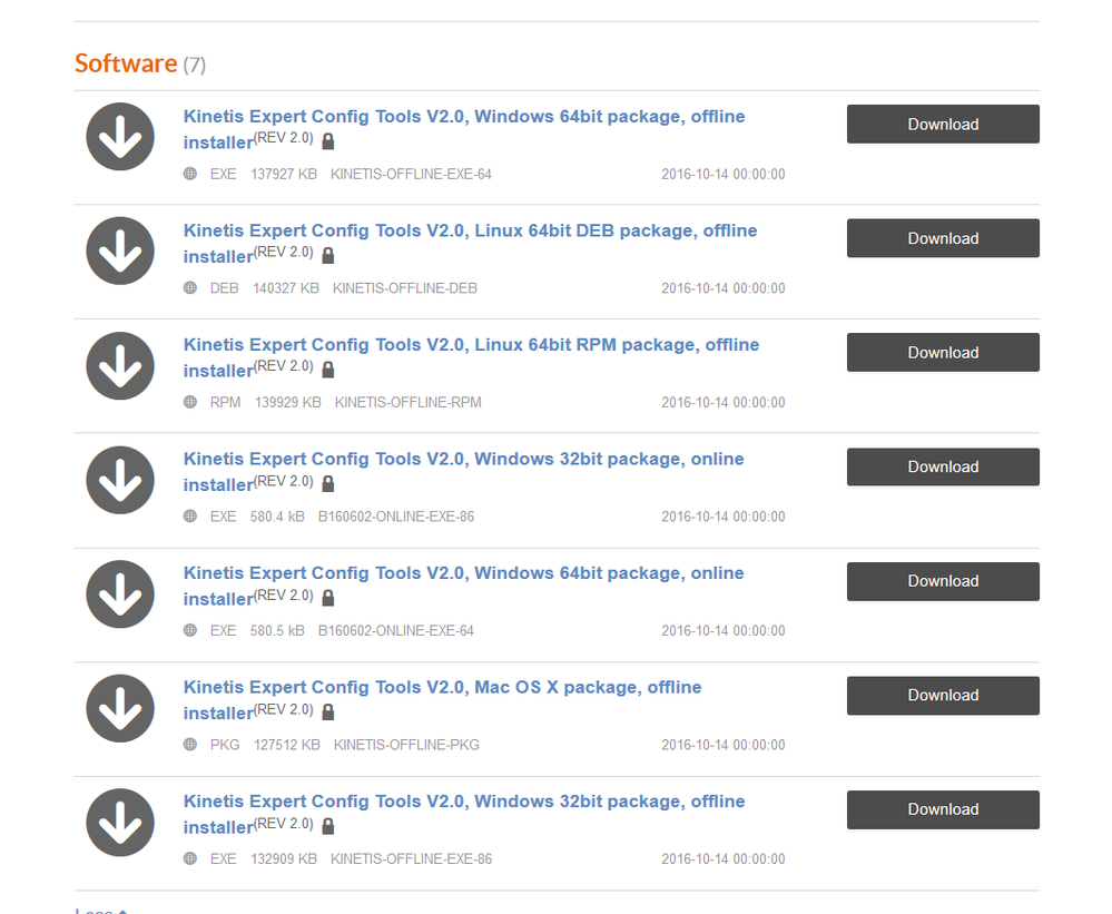

     Can  Processor expert  software  supprot Mke18 mcu? In the Mcuxpress site config the mcu io and clock is slow, have any offline tools for config io and  clock ?

Hello Yu,
There is MCUxpress Config Tool offline version :
Software Development Kit for Kinetis MCUs|NXP
Just now it under Kinetis Expert name, and the offline version only includes small part of chips , new branding and feature updates available March 2017 .  I recommend you can use the online version now .
There is a  documents describes how to use this tool in order to generate the routing and muxing for pins: https://community.nxp.com/docs/DOC-333369
