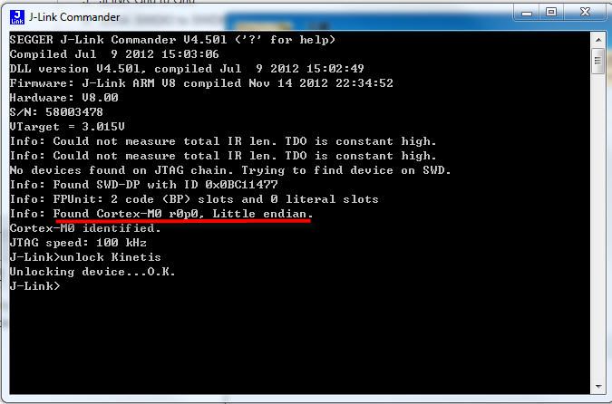

Hui_Ma
Could you try to add a 10K pull up resistor with SWDIO pin? If there still with problem, could you post the J-Link Commander software print info? It will show if J-Link find a device and related info. I attached my screen copy for your reference.
6,757 Views

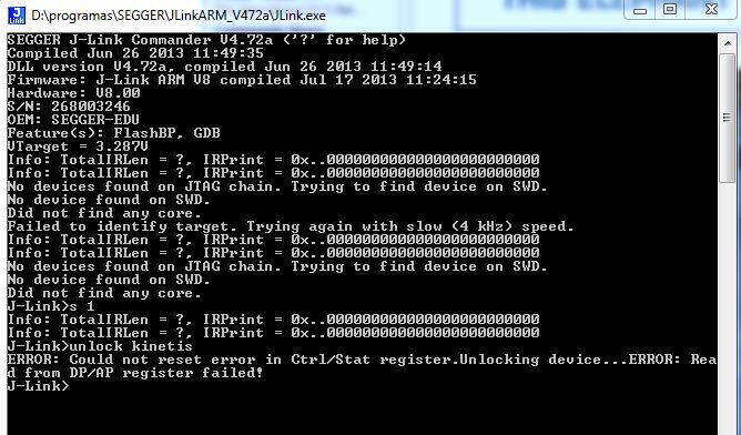

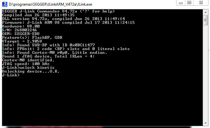

atwoz
Hello Hui,
I added the resistor. No luck.
Here are 2 screenshots, one with the direct connection to the KL04 MCU and one connected to the freedom board using the Jtag header.
1) First screen is the KL04MCU connected directly to the JLINK (it has a pullup in the reset and the SWDIO line)
2) Second screen is the connection to the freedom board.

Hui_Ma
I checked your hardware connection, there without any problem.
Have you check if there exists rosin joint on your board?
And I check you are using FRDM-KL05 board to do the J-Link connection test.
Do you have tried to replace KL04 chip on your board with KL05 chip? If KL05 chip mounted on your board could be connected?
