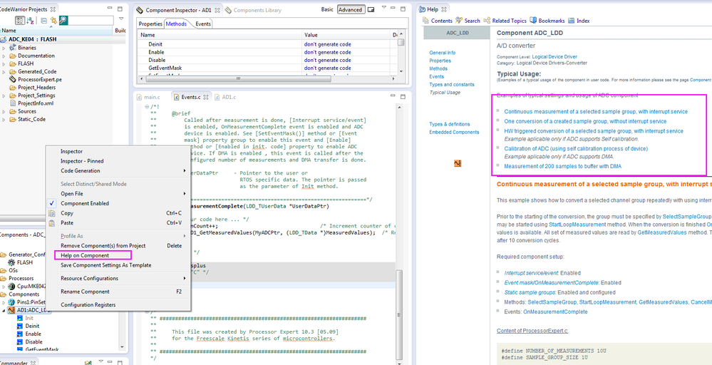

I have some ADC read function like this :
if(!UsbTmtUINT16(hw_uLeesAD(AD_Speaker)))            return;
if(!UsbTmtUINT16(hw_uLeesAD(AD_Aux)))                return;
This example sends the speakers AD value and the Aux Ad value to a PC (and 22 other ADC's)

This code selects the correct ADC input (selected by AdcInput), and returns the ADC value from the ADC.
The problem i have is that the ADC value which is send is always the previous ADC value, so in above example i get at the PC side AD_Speaker when i expect AD_Aux. When i replace all hw_uLeesAD(AD_XXX) by constants , then it works fine.
When i run the function 2 times like this , then i receive the correct ADC value:
uint16_t adcval;
adcval = hw_uLeesAD(AD_Speaker);
adcval = hw_uLeesAD(AD_Aux);
It looks like ADC_GetMeasuredValues returns a previous ADC value, but i can't find out why.

I do not want to use interrupts, i think this is a bug in processor expert .
Already replaced the ADC code with my own code which address the ADC registers directly, and now it works fine.

Hi Steve,
Could you please check the ADC Result register , or the in the memory view to check it,
whether the data is right.
If it really a bug, i will report it to PE team, and solve it . While just now , i don't
know you meaning where is the bug ? A function ? Or anything else ?  Or the ADC result ?
