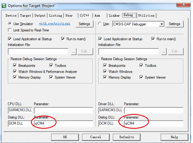

hi,
when I install the KSDK 1.3,   I open an example project use keil mdk.  after sucessfully build the project, but I can't use simulater to debug.
I think maybe I use a wrong parameter for MK22FN512, I look for some manuals for MK22, but i can't
find the right parameter.
so could you tell me the right parameter, or MK22 is not supported for simutaler?
thank you!

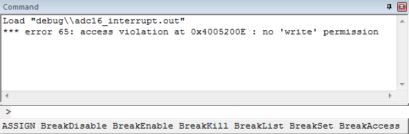

You can have a look at "uVISION DEBUGGER: Simulation of Cortex-M Devices", the K22 is not on the list.
The 0x4005200E is the address of WDOG.
