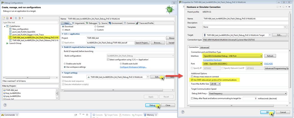

we have a new TWR-K64F120M Kit, that shows an Open SDA driver when we connect it to USB. I wanted to create a MQX 4.1.1 httpsrv RTCS demo project, but in the debugger connection page there is no Open SDA choice. I find there Open Source JTAG and different P&E adapters, but no Open SDA. What am I missing?

I will check this issue you are reporting. As a workaround you can select any of the connections in the Debugger connection list in the new project wizard, then, in the Debug configuration window you can create a new connection or simply modify one of the available connections. Please refer to the image below.

This works, thanks!
