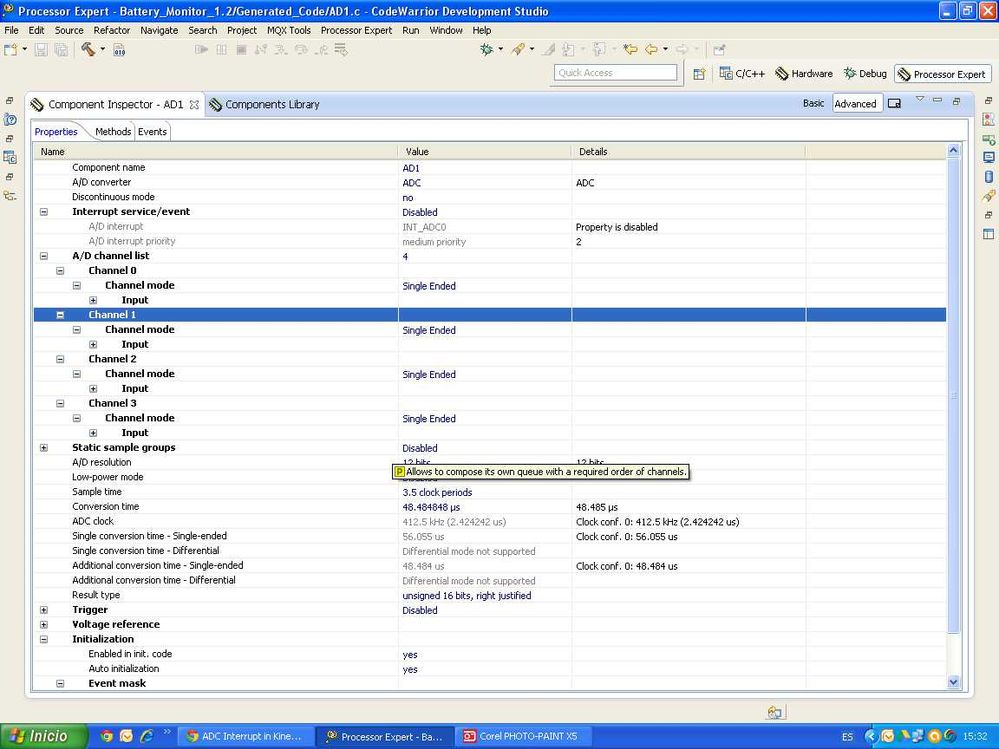

Hi there, I'm trying to implement a synchronous measure of samples using as time base a timer interrupt. To do this I chose the ADC One Conversion method inside a timer interrupt in this way:
On Processor Expert:
1. Set Interrupt service / event = Disable (As the Processor Expert help suggest for One Convertion method)
2. SetUp A/D Channel List with my 4 ADC inputs.
3. SetUp Static sample group indexed to my 4 ADC inputs.

PabloA
Dear Alice, thank you for your time.
I read One conversion of a created sample group, without interrupt service in the ADC_LDD Help, in fact, Interrupt service/event is disabled in the Processor Expert. Is this enough to make a single conversion without interrupts?
GetMeasurementCompleteStatus don't return conversion complete status and the processor can't go out from the while loop, previous ADC_StartSingleMeasurement.
I missing something that I can't see yet.
Regards.

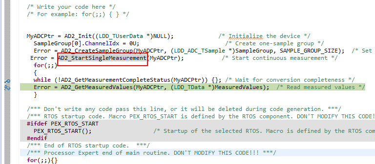

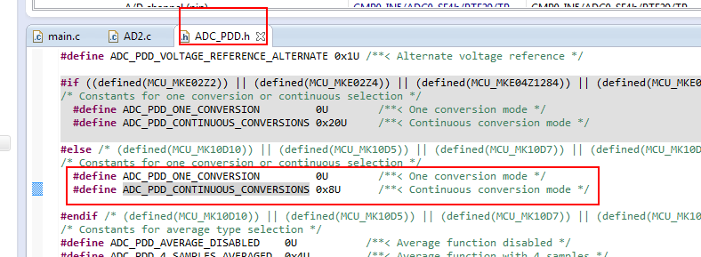

Hi Pablo,
About one conversion mode or continuous conversion mode , you need  config on "ADC_PDD_SetContinuousMode()" function.
If you haven't config ,the default is "one conversion mode" .
Detail processing please refer to the screenshot below :
Alice
Note: If this post answers your question, please click the Correct Answer button. Thank you for your support to us!

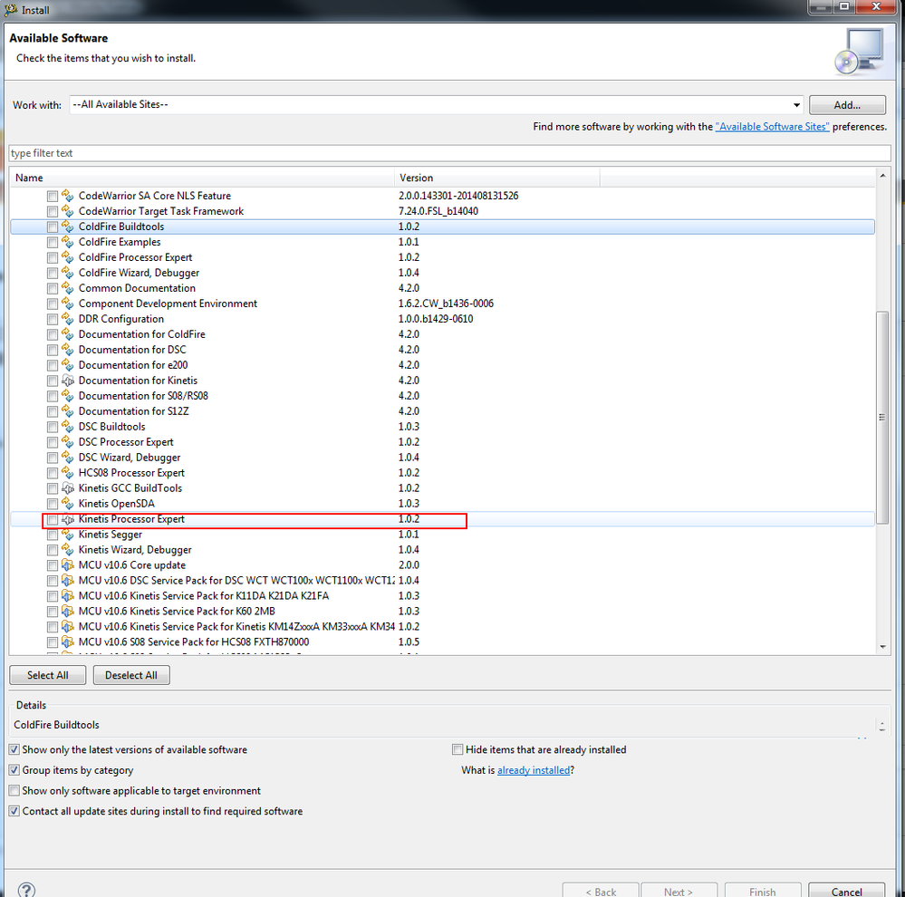

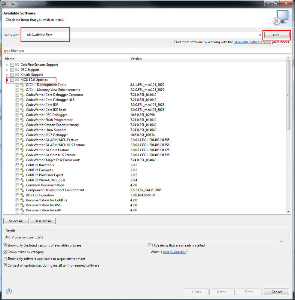

Hello Pablo,
Yes, CW10.6 is the latest version .
And check the  Processor Expert , whether is the latest version  : "help ->Install new software ", then refer to  the screenshot :
If this log is colorized , please update it .
if still can't work ,can you send your project to me ?
Alice
7,569 Views
PabloA
Dear Alice, today I spent 4Hs reinstalling CW to SE Version and updating all of components. This is my Available Software Window:
But, unfortunately, Components Inspector don't have any place to change single measure to continuous conversion mode or vice versa.
I found the ADC_PDD_SetContinuousMode() function that you refer me in the PDD folder, but I don't know how to use it.
So, here you have my code. I hope I'm very confused, it can't be so difficult.
Best regards!
Pablo
