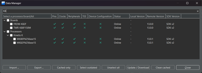

Selecting the clock, pins and peripherals configuration buttons from MCUXpresso IDE with a project for MK81FN256 I get the following error which prevents me to configure and autogenerate the code.

Hi @opetrone,
Unfortunately, the MK81 is not supported on ConfigTools. As you can see from the following image of the ConfigTool's Data Manager, it only supports MK80 and MK82.
I apologize for the inconvenience this may cause.
