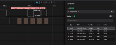

Hi All,
I am using MKE17Z256 micro-controller, and I have to communicate with an another chip over SPI, but without SDI and Chip Select Pin, which means I want to use FlexIO in SPI but without Chip Select and Serial Data Input. I took the FlexIO SPI example from the SDK, and removed the LSPI Slave related code to keep things simple, but I am facing a problem that data doesn't seems transmitted properly (my observation is data transmitted is correct, but there is some issue with the Clock line, probably Chip Select or SDI are not disabled and hence this is happening)

I transmitted 0x00, 0x01, 0x02, 0x03, 0x04, but as per Logic Analyzer I am getting 0x00, 0x00, 0x40, 0x40, 0x40, 0x30
If u see the logic analyzer window it seems that data is fine, but clock is the problem and due to which data is not decoded properly.
Since I used FlexIO-4 as SDO and FlexIO-0 as Clock, and as I did not configured Chip Select and SDI, so they will also becomes "0" means FlexIO-0 pin, and somehow this is causing the problem.

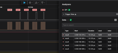

So, to solve this I did a workaround, I assigned SDI and Chip Select pin to some other FlexIO Pin i.e. 1 in this case. and then enabled these pins in code.
The change from the above code is as below.
#define FLEXIO_SPI_SOUT_PIN        4U
#define FLEXIO_SPI_CLK_PIN         0U
#define FLEXIO_SPI_SIN_PIN         1U   // dummy
#define FLEXIO_SPI_PCS_PIN         1U   // dummy
// and then below changes
    spiDev.flexioBase      = MASTER_FLEXIO_SPI_BASEADDR;
    spiDev.SDOPinIndex     = FLEXIO_SPI_SOUT_PIN;
    spiDev.SDIPinIndex     = FLEXIO_SPI_SIN_PIN;    // enabled with dummy FlexIO pin
    spiDev.SCKPinIndex     = FLEXIO_SPI_CLK_PIN;
    spiDev.CSnPinIndex     = FLEXIO_SPI_PCS_PIN;    // enabled with dummy FlexIO pin
    spiDev.shifterIndex[0] = 0U;
    spiDev.shifterIndex[1] = 1U;
    spiDev.timerIndex[0]   = 0U;
    spiDev.timerIndex[1]   = 1U;
And after these changes it started working, as can be seen below.
The problem is I don't have spare pins to be used like this, I assume there might be some other way also, but I am not able to understand properly how to achieve this using shifters and timers configuration.
