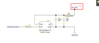

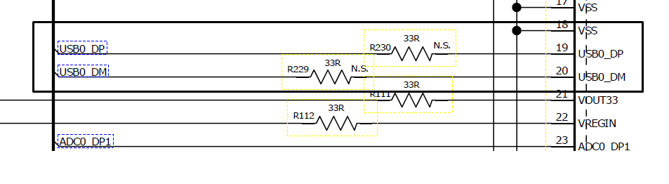

hi, we desing custom pcb with k64, we are trying to communite via usb, when usb disk attached, i get USB_HostEventEnumerationFail, when i examine the signal with oscilloscope, i get such a signal. Do you have any idea about this problem ? ide : McuXpresso sdk : 2.8.2WhatsApp Image 2020-11-10 at 10.51.31 AM (1).jpegWhatsApp Image 2020-11-10 at 10.51.31 AM (1).jpeg

Problem Solved: the schematic was wrong, . i connect 5v to k64 Usb reg. it worked.

actually i checked the OSCs. links like this. OSC output so I measure the clk voltage 5.1 volts, do you think this could be a mistake? OSC VDD 3.3v

mcu : 144pin, MK64FN1M0VLQ12

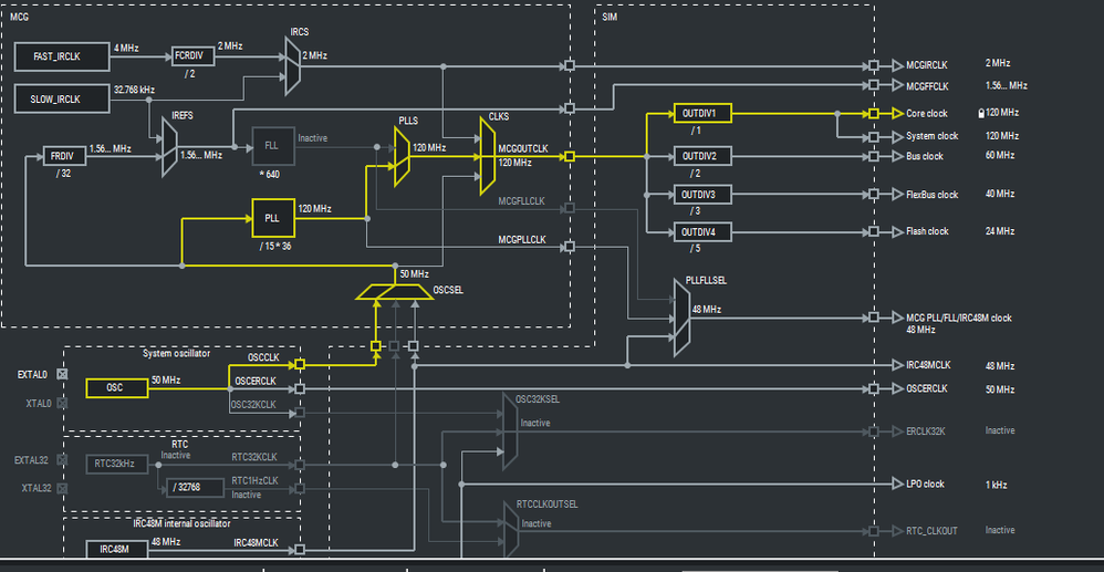

we use external clock for usb and mcu. usb clk in : 47 - PTE26
we are only testing usb msd example.first we tested the code without any change on our circuit but did not work,
second we created a clean project for out 144 pin mcu and tested again(usb msd) but not a chance.
example working on nxp development board but not working our board.  i want to know, is this usb signal correct ?
it works until this function( USB_HostEvent() ) and i get enumeration error.code.pngcode.pngosi.pngosi.pngprojeicindekiler.pngprojeicindekiler.pngusb.pngusb.png
