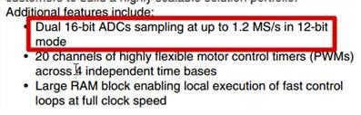

I am trying to help my customer to achieve higher speed on the ADC peripheral, Could you please advise how can I get the maximum sampling time into the KV31P100M120SF7.
According to the datasheet, the maximum sampling in 12-bit is 1.2MS/s.

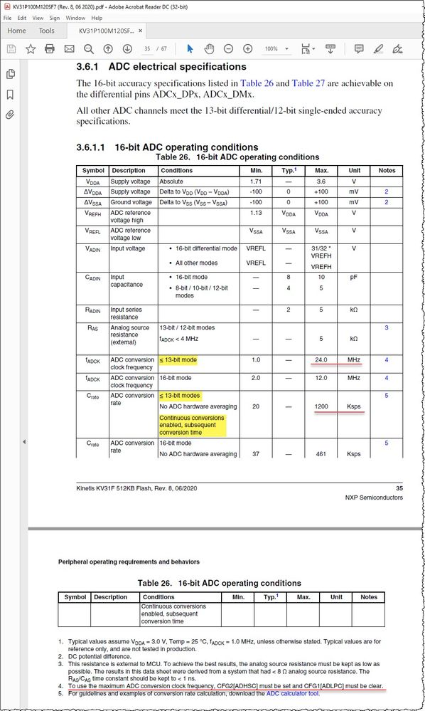

According to the datasheet, you need to configure:
fADCK(ADC conversion clock frequency)=24MHz
12bit mode
CFG2[ADHSC] must be set and CFG1[ADLPC] must be clear
1200Ksps 12bit ADC Continuous conversions enabled, subsequent conversion time.jpg1200Ksps 12bit ADC Continuous conversions enabled, subsequent conversion time.jpg
Then you will get the 1200 Ksps Crate(ADC conversionrate).
Notice: No ADC hardware averaging Continuous conversions enabled, subsequent conversion time
Please check whether the ADC clock source in your configuration can be divided to 24MHz.
According to your codes, I can see you configure the Core clock to 120MHz.
But I don't know the frequency of Bus clock.(I am afraid 120MHz MCGOUTCLK can't divide to 48MHz or 24MHz Bus clock)
It caused you can't achieve 1200 Ksps ADC.

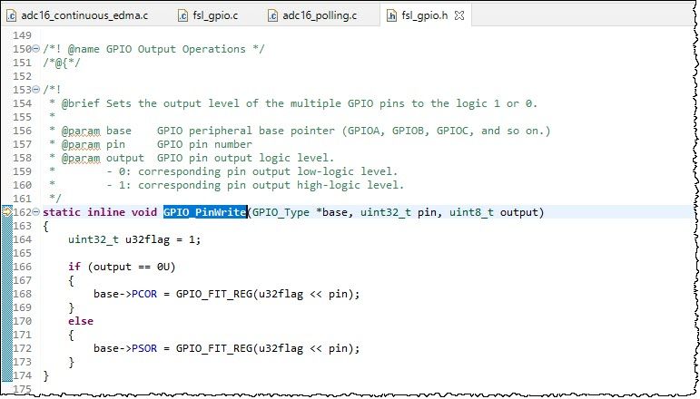

In addition, the example project of ADC polling mode contains the following condition for the end of conversion.
while (0U == (kADC16_ChannelConversionDoneFlag &
ADC16_GetChannelStatusFlags(DEMO_ADC16_BASE, DEMO_ADC16_CHANNEL_GROUP)))
Is it enough to wait only to  kADC16_ChannelConversionDoneFlag? If yes, the ADC sampling time will improve to 1u.
One more question, what is the fast way to read and set the GPIO?
The function of GPIO_PinWrite takes around – ~0.4µsec (while working MCGOUTCLK as 120MHz).
Waiting for your feedback, Thanks in advance.

GPIO_PinWrite will determine whether to set or clear, maybe you can direct write the PCOR or PSOR register.(But I don't think it will not reduce too much time consumption)

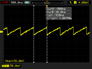

Robin_Shen

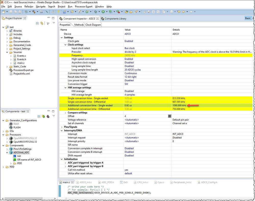

I used the Processor Expert tool in KDS to configure a simple test project to quickly verify the ADC sampling frequency. (The ADC clock source is Bus Clock, which is divided down to 24MHz for ADC use)

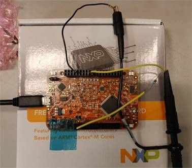

Robin_Shen

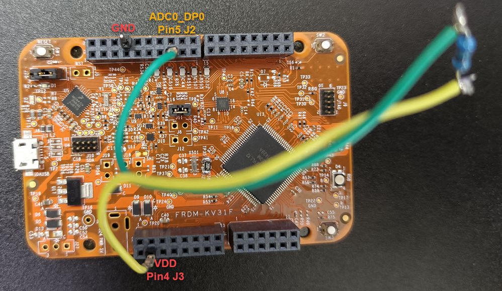

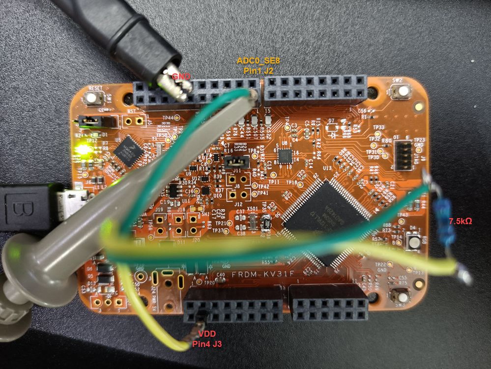

For more detail about the the figure of the scope, you may need to read verify ADC conversion rate with oscilloscope.
The probe of oscilloscope is connect at ADC0_DP0_RC(Pin5 J2) of FRDM-KV31F board.

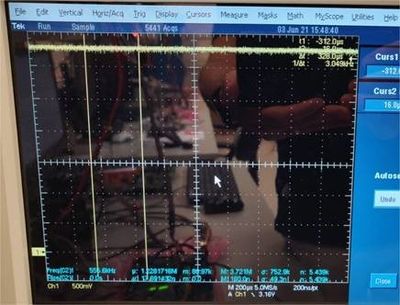

shai_b
Senior Contributor II
Dear @Robin_Shen,
Thanks for your great support and info.
There is bad and good news.
The bad news is that I made the same test as below and didn’t get the figures that you achieved.
I was using with 2K resistor and ADC0_SE8 pin.
I would be happy to understand what am I missing.
The good news is that when I bypass the function of the GPIO driver and set\get directly from the registers the TP time is improved.
For example, the GPIO_PinWrite function takes around 500nSec but when I set the IO directly from the registers is takes 160nSec.
520nSec -> GPIO_PinWrite(BOARD_DBG_GPIO, BOARD_DBG_GPIO_PIN, LOGIC_HIGH);
160nSec -> BOARD_DBG_GPIO->PSOR = GPIO_FIT_REG(u32flag << BOARD_DBG_GPIO_PIN);
Waiting for your kind comment on how I can reach a better conversion time as you managed to reach?

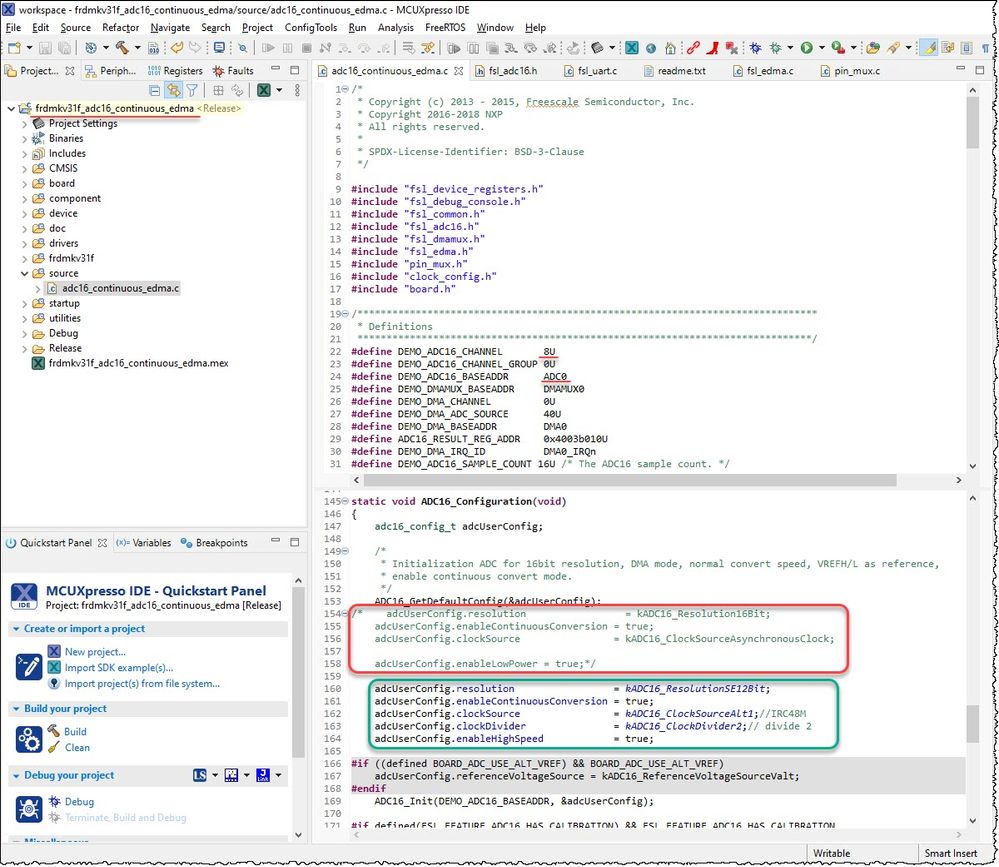

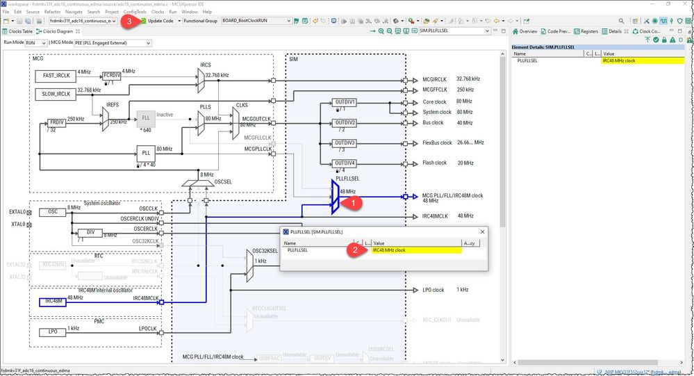

Robin_Shen
I modify the  frdmkv31f_adc16_continuous_edma based on SDK_2.9.0_FRDM-KV31F with MCUXpresso IDE v11.3.1_5262.
You can refer the modification shown below:
MCG PLL FLL IRC48M clock.jpgMCG PLL FLL IRC48M clock.jpgfrdmkv31f_adc16_continuous_edma.jpgfrdmkv31f_adc16_continuous_edma.jpg1623055724683.jpg1623055724683.jpg
notice the setting of oscilloscope: AC 20mV 920ns.bmp920ns.bmp
Customer can direct test the attached project.
Robin
