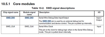

Hi.
I recently designed a test pcb for this MCU, the way i program the pcb is through USB port so i'm not using  the SWD port and have it disconnected, but i want/need to use this pin as GPIO it's default is SWD_DIO. The problem is when i configure that port to work as GPIO by writing '1' in the mux it just does not goes to 'o' logic i'm always getting high as output.
This is how i'm setting ports as outputs:
SIM_SCGC5 |= SIM_SCGC5_PORTB_MASK// Turn on the port.
SIM_SCGC5 |= SIM_SCGC5_PORTA_MASK
PORTB_PCR19 |= PORT_PCR_MUX(1);// select ALT 1 of mux (GPIO)
PORTB_PCR18 |= PORT_PCR_MUX(1);// 20
PORTA_PCR3 |= PORT_PCR_MUX(1);// 11
GPIOB_PDDR |= 1<<19;
GPIOB_PDDR |= 1<<18;
GPIOA_PDDR |= 1<<3;
Then in my program i use PSOR, PCOR, PTOR, PTB19 and PTB18 correctly change it's state, but PTA3 do nothing. I was thinking the reason for it is that this pin has an internal pullup resistor, but the reference manual does not give information about it.
It is possible to use this PTA3 as GPIO? Or which is the reason that i can't change the state to low?.

danielchen
Please refer to reference manual.   SWD_DIO is pulled up internally, should be disabled.
