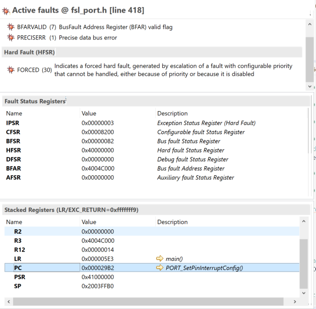

Hi, I am new to this. I am trying out to understand the development environment. I am using FRDMK28F board using the gpio_input_interupt example. I manage to load and run the example and pressing SW2 to switch on the RED LED.
I am trying to figure out for instance with multiple GPIO interupt. for example adding SW3 to switch on/off GREEN LED.
I have tried duplicating the codes and add them as follow but it didn't work. Can anyone advise. Thanks.

The problems you are having are because you do not have the Clock Gating for PORTD configured.
If you're making the changes from the gpio_input_interupt example, you have to make sure that SW3 has its clock enabled (it's the one corresponding to PORTD) and its PIN (pin 0) is set as GPIO. This can be achieved by adding this two lines in your code:
    /* Port D Clock Gate Control: Clock enabled */
    CLOCK_EnableClock(kCLOCK_PortD);
    /* PORTD0 (pin A6) is configured as PTD0 */
    PORT_SetPinMux(PORTD, 0U, kPORT_MuxAsGpio);
The same thing needs to be done when you try to use the GREEN LED (Here the its PORTE and PIN7):
    /* Port E Clock Gate Control: Clock enabled */
    CLOCK_EnableClock(kCLOCK_PortE);
    /* PORTE6 (pin E2) is configured as PTE6 */
    PORT_SetPinMux(PORTE, 7U, kPORT_MuxAsGpio);
These lines have to go before setting the pin interrupt configuration. They usually go inside the BOARD_InitPins() function, but since you're making the modifications from the driver example, they are not initially added.
I hope this information can help you.
