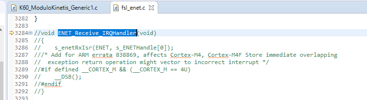

7) After Ricardo's step 6, I had to comment the following interrupt function, as it was beeing set twice

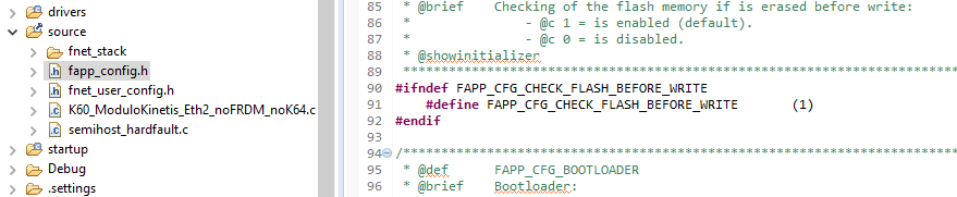

8) I also had to add the fapp_config.h from one of the fnet stak examples as done for the fnet_user_config.h previously
9) In order to define the IP and MAC you should open the fapp_config.h and set it in the define FAPP_CFG_ETH0_IP4_ADDR
