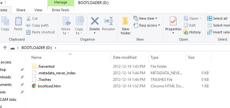

The issue is that when I plug the board into my laptop it doesn't appear as a MBED Drive and the virtual COM Port isn't created. But the LED blinks when I tilt the board so I know that the MCU is working and is running the demo code. I've tried going through the OpenSDA documentation and I've found that my bootlader doesn't match what is shown in the documentation (Figure 2).
                                                  Figure 1. Bootloader from my TWR-KV58220M board

If I understand your issue correctly, is that when you plug the board into your laptop it doesn't appear as a MBED Drive and the virtual COM Port isn't created. If that is the case, then in order to achieve this when you plug your board into your PC you have to enter ISP mode with the board (unplug the board from your pc, press the reset button and then plug the board again while keeping the button pressed).

Yes this is my underlying issue, which would then prevent me from programming the board over OpenSDA. I have already done what you suggested since this was how I got the the bootloader drive I showed in my post. My computer does recognize the board as a MBED device but no virtual COM Port is created.

4) Connect your board to your PC with ISP mode and drag/copy the bin downloaded in the previous step into the BOOTLOADER of the board:
5) Unplug and plug the board again, and you should see that the virtual COM Port is now created (COM 11):
I hope this small guide can help you with your issue.
