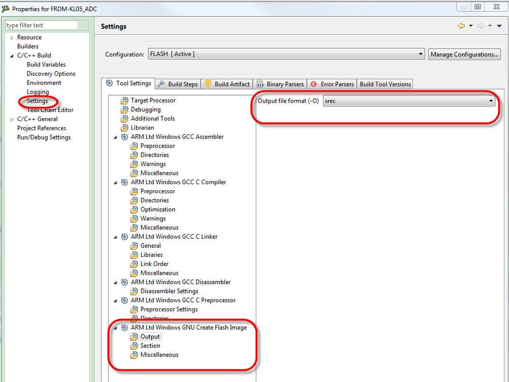

BlackNight
Looks like you are using the legacy Freescale compiler (not the new GNU ARM gcc one).
This compiler only offers to generate an S19 file in the linker options.
I recommend that you either use GNU ARM gcc compiler in CodeWarrior, or have a look at these forum posts:
S19 vs. HEX
CW 10.2 / K70 How to create S19 or other file for Flash burn

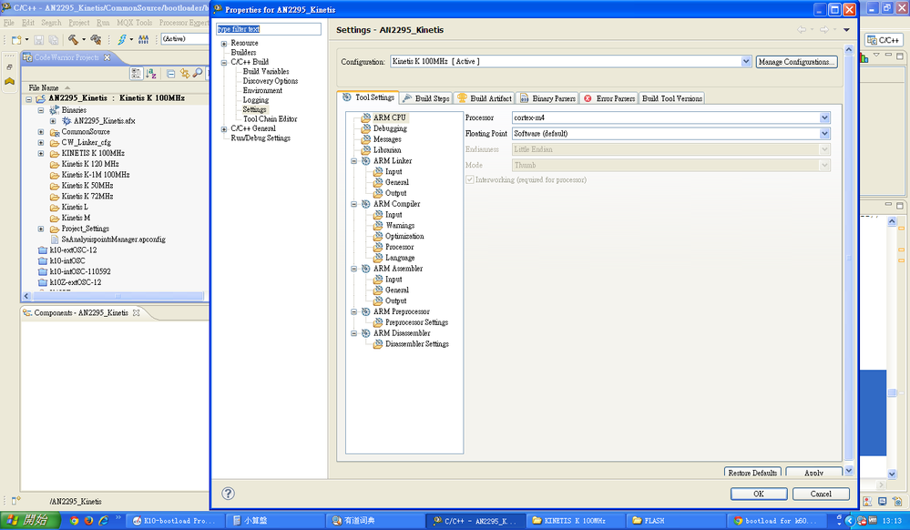

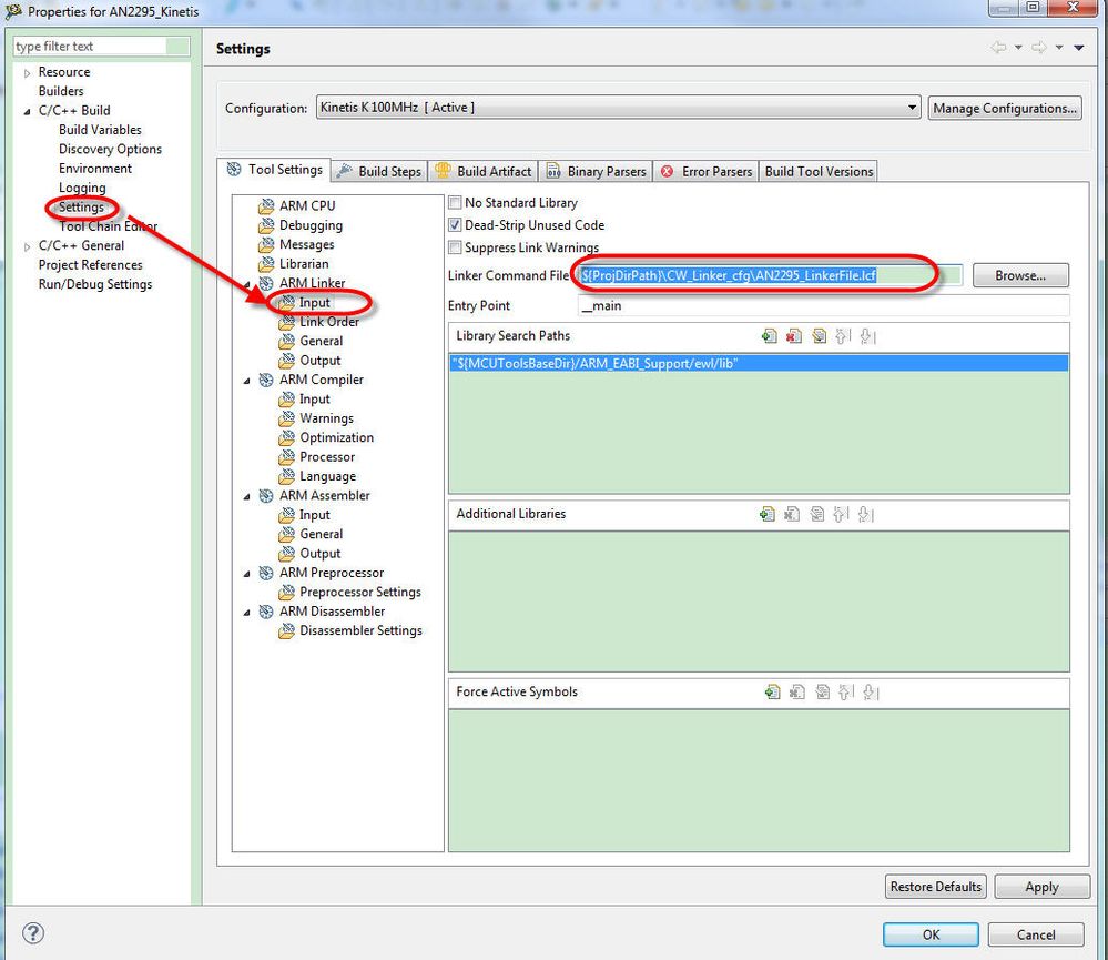

Hui_Ma
For the <bootloader_asm.s> file is bootloader jump to application function for KEIL compiler, please remove this file for CodeWarrior project compile.
And after that, customer need clear the project, please select menu "Project -> Clean..." to clear this project.
Then, customer need modify the link file address, which using the absolute address for that file, customer can modify it with below path:
${ProjDirPath}\CW_Linker_cfg\AN2295_LinkerFile.lcf
The below picture for more detailed info, after that, there with no compile issue about this project.
Wish it helps.

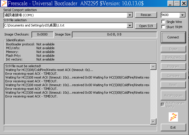

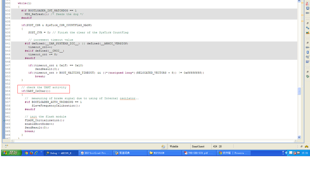

李志權

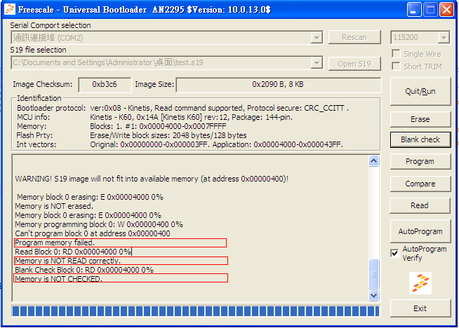

When I debug, also found a problem:
When I click on the Connect, there will be a timeout,just like
Using a serial port debug tool, found that it is to get the data
But in the code, it is also read in the data
so,What is the problem?
9,052 Views

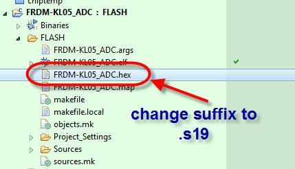

Hui_Ma

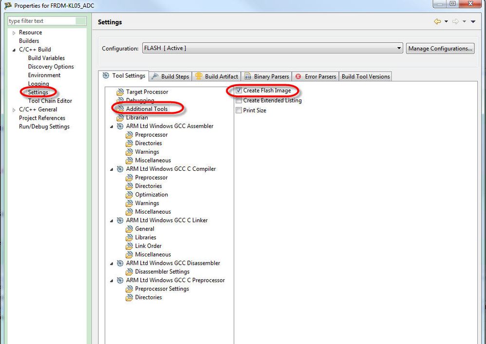

About how to generate S19 file, you can refer below picture for CW project:
Step 1:
Step 2:
Step 3:
I also recommend to refer below link about application link config file:
I have writed a application with a serial bootloader support for TWR-K60D100M
Wish it helps.

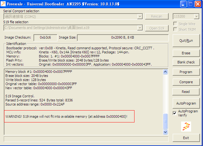

I according to your method to generate the s19 file, and the connection, but it hints
when i click AutoProgram、Read、BlankCheck ,it show
9,052 Views

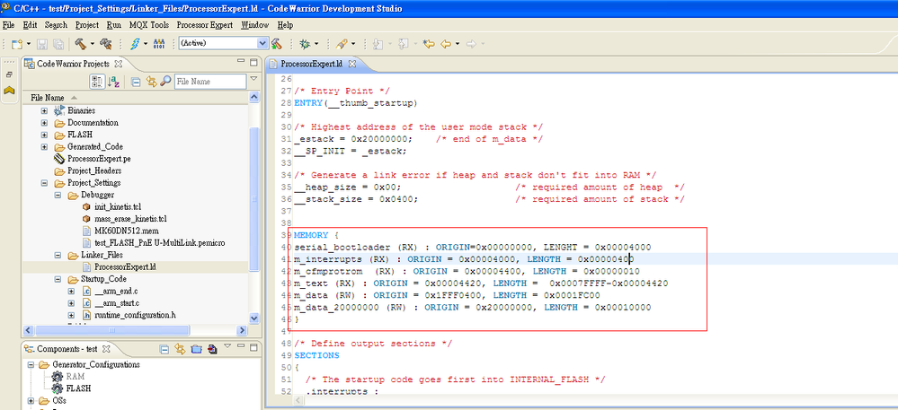

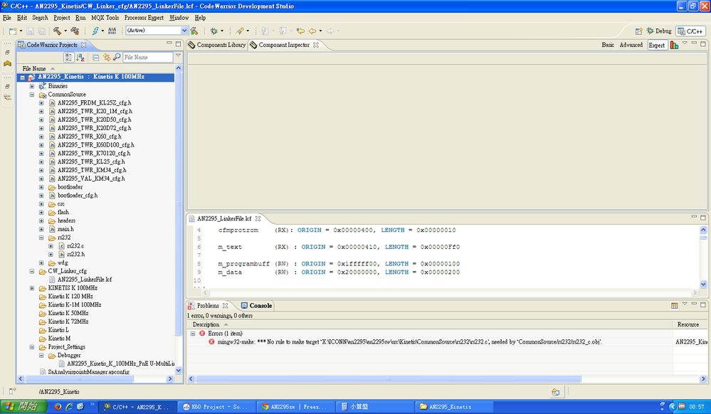

Hui_Ma
The application code need start address at 0x4000, customer need to modify the application project link configure file (.lcf) to set the application code start address.
Wish it helps.
9,052 Views

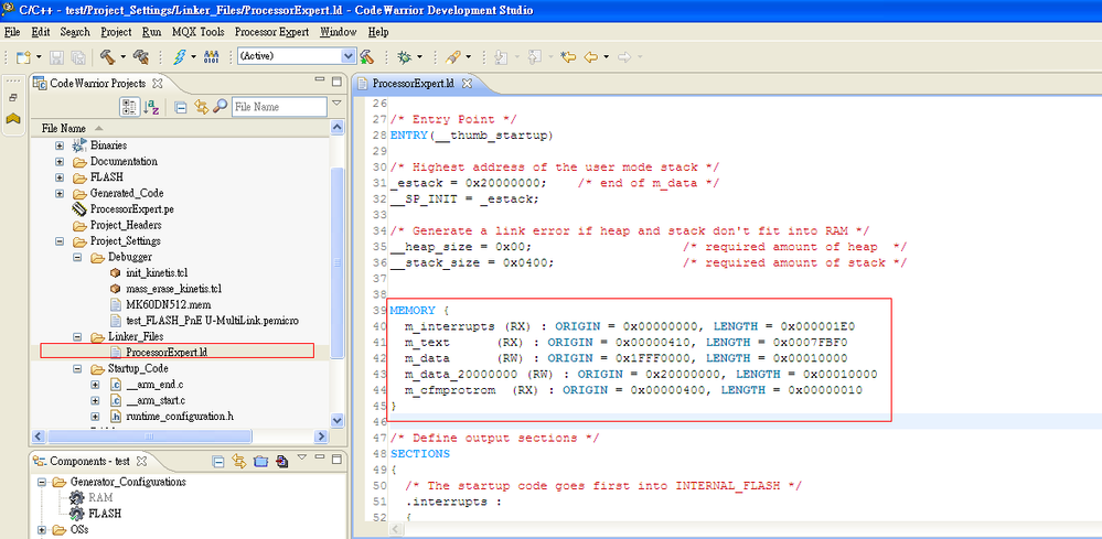

李志權
I didn't find the LCF files in the project, but have found. Ld file
And then the start address modification into 0 x4000
But after recompile, and become the original value
9,052 Views

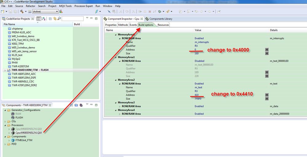

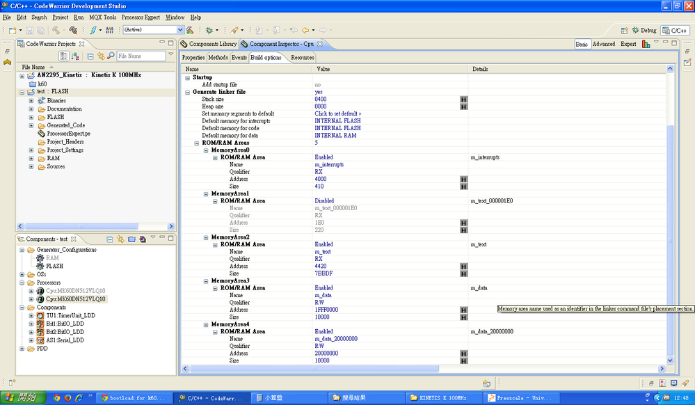

Hui_Ma
For you are using Processor Expert tool, it need to set the Processors' Component Inspector [Build options] to set ROM/RAM Areas.
Please check below picture for more detailed info:
Wish it helps.
9,052 Views
李志權
Change the address after compile successfully:
But burning program still fail:
9,052 Views

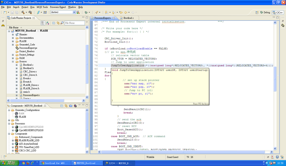

李志權
I according to the code of AN2295, rewriting a bootload, now can download S19 file correctly.
But I can only use RAM way can jump to APP, use FLASH mode will not be able to jump to the APP
9,052 Views
