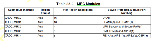

MarMi
Hi Bogdan,
I got manual of the Rayleigh device.
Here is Memory Region Controller assignment to protected slaves.pastedImage_1.png
Provided you don't configure access to XRDC prior it is enabled then access will not be granted.
In order to allow access to XRDC (placed @ AIPS-0, slots 28-to-31), I think you should do these steps:
1. Program XRDC_MRC3 (XRDC_MRGD_Wx_48) to allow access into AIPS0 address range for given domainID
2. Program XRDC_PAC0 (XRDC_PDAC_Wx_028 - XRDC_PDAC_Wx_031) to allow access to all four XRDC peripheral slots for given domainID
3. Some registers, for example XRDC_CR requires core master to use Secure Privileged access attribute to be able to read it or modify and therefore you might need to setup also respective XRDC_PID for generating secure access attribute { PID[5] = 1 }.
Unfortunately, I cannot try practically on board this setting and therefore my advice is pure theoretical based on understanding XRDC block IP.
Kind regards,
Martin M.
