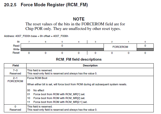

We are building a device around the KL27Z.  Once it has been packaged and sealed, the only access we have to it is the serial port.  (In particular, no USB, no reset button.)  Once in a while, we would like to be able to update the application code running in the processor.
So my question is: is there a serial bootloader -- either resident in ROM or available to incorporate into our application -- that we can call on demand that will allow re-flashing of the application code via the serial port?
Naturally, we would have a dedicated app running on the host processor on the other end of the serial line.
I've looked over a few documents, e.g. http://www.nxp.com/assets/documents/data/en/user-guides/KFLLDRUG.pdf  and http://www.nxp.com/assets/documents/data/en/user-guides/KBTLDRDEMOUG.pdf , and I have to admit I don't understand the difference between 'bootloader' and 'flashloader' (if there is actually a difference).  But more to the point, I'm not sure what's available.
Oh, one final word: if we absolutely need a reset line or some external signal to invoke the bootloader, we can probably provide that.
Pointers and example are welcome!

The KL27 contains a serial loader in its ROM that can be started via command. It requires the NXP loader software on the PC to work with.

The built-in ROM loader is probably our best option (especially since program space is precious).  Am I correct in thinking this is the document that says how to call it from a user program:
    http://www.nxp.com/assets/documents/data/en/reference-manuals/KBTLDR200RM.pdf
(Section 2.6, "Bootloader Entry Point"), or is there some other document I should be reading as well?

I would use the following register to do it:
