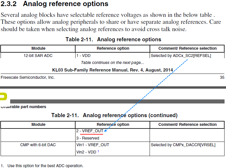

On the KL03 does this select VREF_OUT as the (internally generated) ADC voltage reference?
Yes. You can find below information from it's Reference Manual KL03P24M48SF0RM.

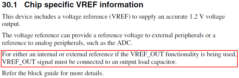

And if so, if we are only using VREF_OUT as the internal ADC reference, do we still need the 100nf Cap?
Yes.
