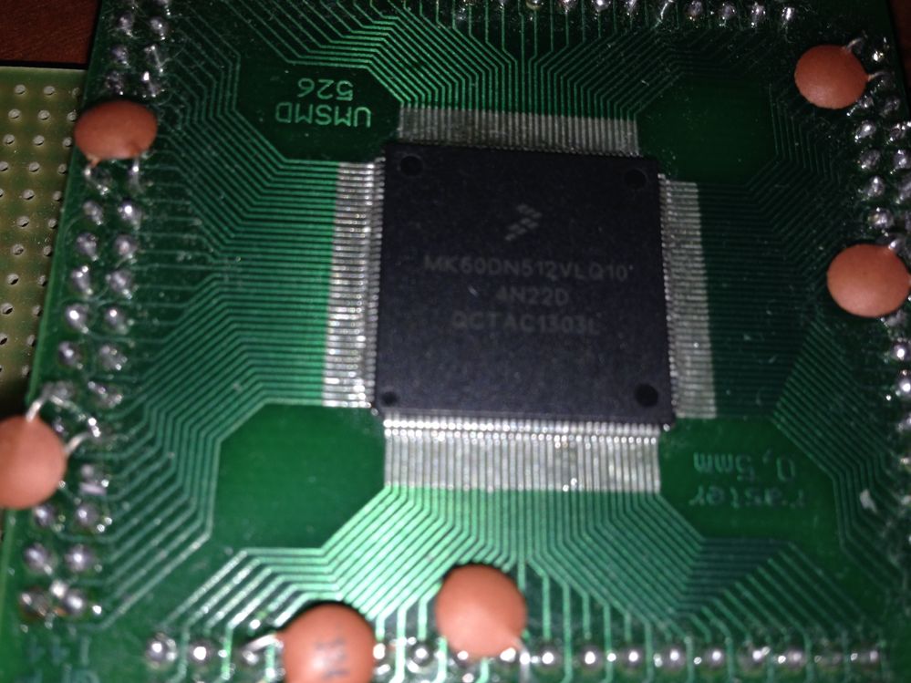

alexpaul
Hi Kan,
im using my own board with k60 as on photo, Btw all code was generated for AS1, i dont know why im getting this error i uploaded this project with correct k60 for my board.

Kan_Li
Hi Alex,
The device on your board is a silicon rev 2.x, so it is right to create a new project for it, and your issue is due to you didn't enable the methods that can be selected when the "Expert" is clicked. Please kindly refer to the following for details;

alexpaul
Hi Kan,
Thanks now it works :smileyhappy:
im really gratefull for your help and time.
