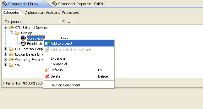

BTW, It looks like you use the UART to output the hashed data, so I think maybe you can use printf() to do that, it can be achieved by adding PE's component "ConsoleIO" instead of "Serial_LDD". Please kindly refer to the following for details.
Hope that helps,

thanks for reply, i tried to add ConsoleIO but there is nothing happend after prinft(out);  i got no result in terra term,
When i changed variable, and send by the Serial_LDD , i got " 1779033703 " Does it mean that conversion sprintf(hashed, "%d ", out);  is wrong? Any idea to stay on Serial_ldd and make this workable?
Regards.

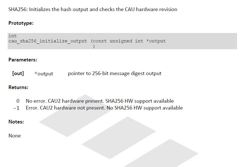

Anyway thanks for clarify using this functions.

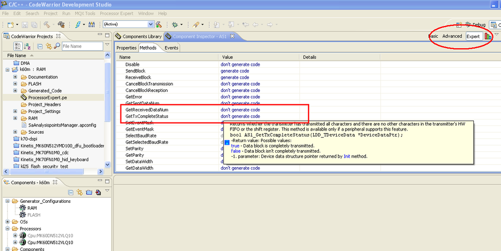

Please kindly refer to the attached project for details, it is based on TWR-K60N512, and you will have the same output as I provided before.

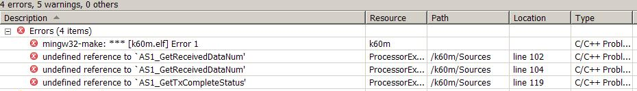

Hi Kan, Thanks for upload this project. Now i thereabout know how it works, but sadly when i imported your project, and tried to compile i got,
Undefined refernce to 'mmcau_sha256_hash and mmcau_sha256_initialize_output, i tried to readd cau_api.h with no success, but i think the problem is in lib_mmcau.a but i can't remeber how i added this in my earlier project. So i opened my old project and replaced procesor expert code with your code, and tried to compile but i got few error's1.JPG.jpgT
Tried to fix it, but when finally compiled and started debugging i got an PE_debughalt; sorry if these problems stem from my lack of knowledge in the fundamentals of using code warrior.i really appreciate your patience. Regards :smileyhappy:
