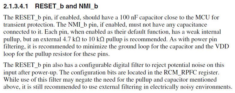

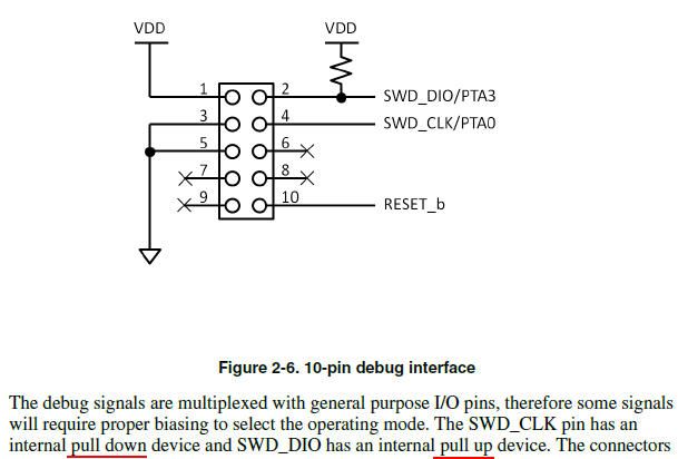

Hi Jacob,
The SWD_CLK pin has an internal pull down and SWD_DIO has an internal pull up. But an external 4.7 kΩ to 10 kΩ pullup is recommended on SWD_DIO. You can refer the 10-pin debug interface below.
And the RESET_b and NMI_b should be care.
Robin

jacobjennings
Resolved: Needed 10k pullup on SWD clk and SWD reset, pulldown on clock
