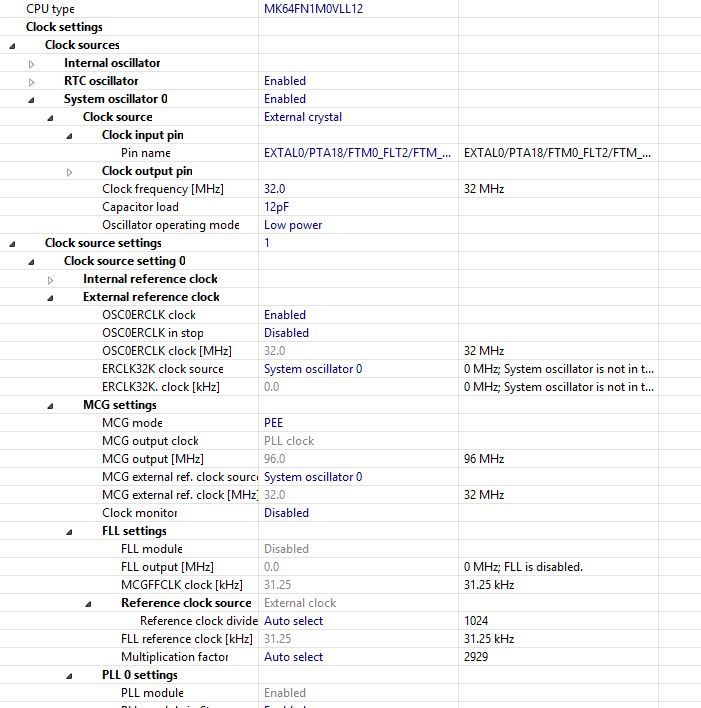

I have successfully accessed USB OTG on FRDM K64FN development board. I have used FSL_USB_STACK in device mode. Now I have designed our own board using same controller i.e MK64FN1M0VLL12 and trying to connect USB OTG on the same. The  connections for USB are as shown in attached image. My issue is that, USB is not getting enumerated when connected in port on new board. The difference between the CPU configuration of development board and designed board is that the dev board uses external reference clock of 50 MHz and I am using external crystal of 32 MHz as clock source. All other CPU settings are same for  both the boards.USB_connections.JPG
Can any one help me to find out the cause of this issue.

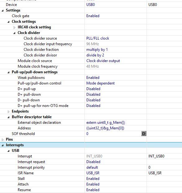

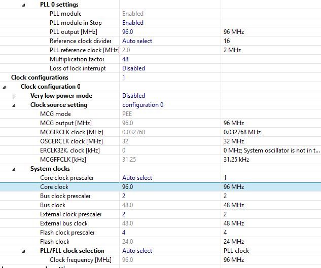

Hi Mark,
Yes, I have connected the 2.2 uF capacitor to VOUT 33 pin. Attached is the screenshot of the same.Vout33_connection.JPG
 USB clock is also set correctly to 48 MHz. Please have a look at CPU settings for external crystal and USB_INIT settings. Still the USB is not enumerated.

3,703件の閲覧回数
kirtiraje
HI Mark,
Finally my USB on new board is enumerated. Issue was with the hardware. I have used external crystal of 32 MHz but the actual frequency of crystal is 10.75MHz. I have replaced the crystal with 12 MHz and accordingly done the CPU settings and USB is working fine now.
Thank you for your help..
Kirti
