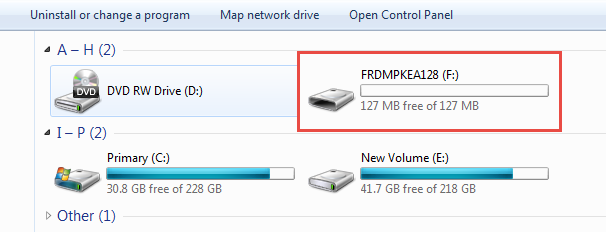

a. In order to enter OpenSDA bootloader mode: unplug the USB cable, hold the reset switch and plug into USB again. If you have the drivers installed, it should show up as a removable storage in file explorer. Open SDA_INFO.HTML to check the status of your bootloader (version etc.). Anyway I think this should work since you say P5V_SDA and P3V3_SDA have power.

I tried following your instructions step by step. When I hold down Reset and plug in the USB cable, the BOOTLOADER drive doesn’t show up. Nothing happens at all. Therefore, I can’t change the Bootloader. Is there another way to change it? Alternately, will NXP exchange these for functioning boards? Thanks for your help.

Hi Adam,
    Do you install the P&E driver in win7?
    When you first plug the board, you need to wait a moment, because the PC need to install it, run the driver automatically.
   So when your enter bootloader mode, can you find any USB device is installing?
   Please also check the PC device manager, this is my situation:
  You can also post your according picture.
Kerry

     Now, please try to enter the bootloader again with your revB board.
     Please note, power off the board, then hold on the reset button, hold on it, plug the usb cable, don't release the reset button, wait about 10 seconds without release the reset button, then check the PC , can you find the BOOTLOADER device or not?
Please also check your device manager, whether there has the new USB controllers?
Please try it now.

adamjohnson
Kerry,
It seems it was the driver. I had installed the driver previously, but I didn't restart after installation. This time, I did, and the board finally came up. I've since updated the bootloader on all three boards, and they seem to be working properly. Thanks for your help!
