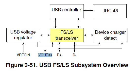

Make sure that you haven't forgotten a 2.2uF capacitor on the VOUT33 pin since this is used to stabilise the power supply to the USB transceiver. And of course that VREGIN is connected to (about) 5V or to the USB bus power line.

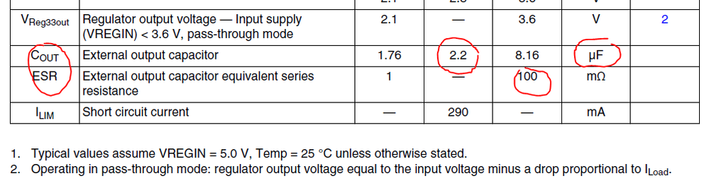

See the K64 electrical specifications (data sheet):
The TWR-K64 does have 0.1uF but the FRDM-K64F has the 2.2uF. Both have a 10uF decoupling on the VREGIN pin.
I don't actually have a TWR-K64 at the moment (I am ordering a further 13 TWR and FRDM boards at the end of the week to ensure that I have the full set again - on top of the 24 that I already have and have built and tested loaders for) so was not aware that the capacitor may be incorrect on it. Whether things still work or not may depend on combined factors though.

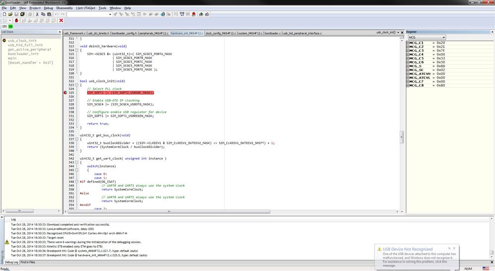

Here are the MCG registers:
