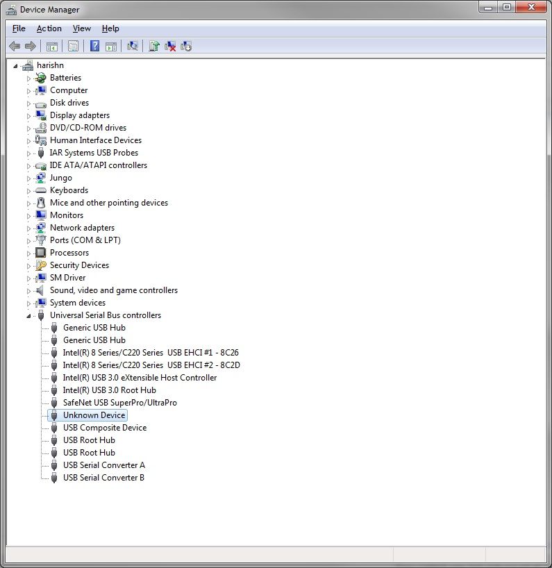

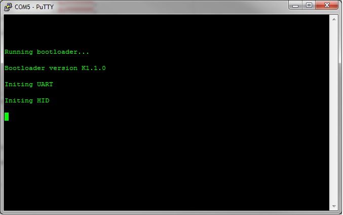

nitinharish
Contributor V
This is my K64 side:
This is the Windows unknown device:

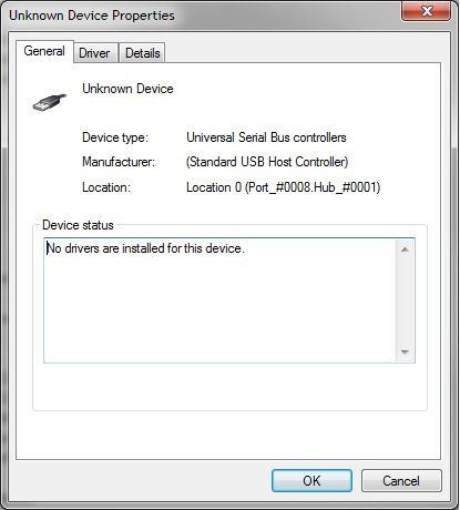

The USB device is HID so it doesn't need a driver as such; this is one nice thing about HID (or MSD) in comparison with CDC, for example.
Unfortunately it is difficult to know what is going on without checking the enumeration with a USB analyser - it sounds like enumeration may be failing but usually there is an error message accompanying this.
Try right clicking on the unknown device and look through the list of properties - does it show that it has understood the PID/VID? Does it say that it is operating successfully or that it couldn't be started? Does it say that its driver is up-to-date?
Mark
P.S: Maybe it is operational but for some reason calls it an unknown device on Win 7 64 bit (I only use Win 7 32 bit)?

nitinharish
Contributor V

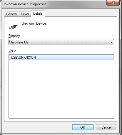

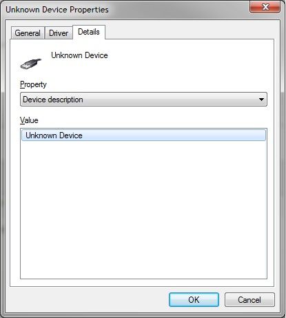

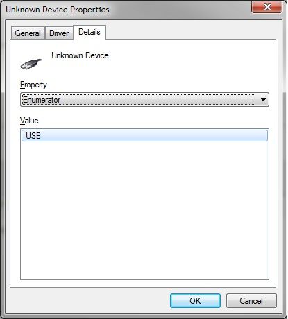

I knew, you will save my boat Mark. (And your delay is really like a real time clock delay :smileyhappy: ~maybe some nanoseconds)
Answers:
Windows Does not recognize the device's PID/VID, see the following pictures.

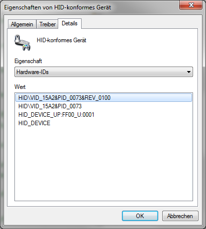

mjbcswitzerland
Specialist V
Nitin
I just tried on the FRDM-K64F board (Windows 7 32 bit).
The device shows up under "human interface devices" and not under the list of controllers - check that yours is not in fact there and so the unknown device could be a red-herring (misleading).
Below are the HW IDs that its characteristics display.
I have attached the binary that I loaded - if your board has a 50MHz oscillator as clock input it may be able to run it. It has KBOOT HID on the USB and the serial mode also on the UART (the one used by the virtual COM on the freedom board). In additional it also has a web server loader on a fixed IP address 192.168.0.125.

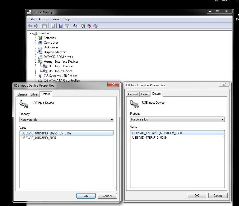

nitinharish
Contributor V
Mark
I verified the devices under HID and none of them are my PID/VID for the baord:
I have 60Mhz external clock.

I just checked the specification fo the oscillator input frequency and it is 50MHz (max.). Therefore a 60MHz clock input is in fact out of specification for fec_extal (although if the PLL is correctly set to 120MHz it would probably be OK (in a laboratory but I woudln't risk it in a 'product')). You can check that the PLL is in fact set correctly by measuring the toggling rate on PTE26 (my version) since it is controlling this via a SW timer based on a 50ms SYSTICK interrupt, which is fed by the system clock (120MHz). If this is inaccurate the USB clock will be as well and certainly USB would then fail.
Mark
8,800 Views
nitinharish
Contributor V
There is a chance that this is a HW releated problem. Do you power via the same cable that you use for the USB?
No, my device is separately powered
My board does not exposes PTE26 for me to put a scope. I need time to investigate this.
You could probably also do the opposite test - change your code back to 50MHz operation
I will email you after I do that tomorrow morning first thing. (My morning in US EST)
THANKS THANKS THANKS THANKS THANKS
8,800 Views
mjbcswitzerland
Specialist V
Nitin
OK.
If you need other ports to toggle (to verify the internal clock speeds) just tell me - I can put them anywhere.
Note: You can also use the CLKOUT pin to measure some internal frequencies (See CLKOUTSEL in SIM_SOPT2) which will give a direct or indirect measurement (although the SW toggle is fine for determining the system clock rate since it is derived from it).
Mark
8,800 Views
nitinharish
Contributor V
Mark
Attached is my version of SW with 50Hz, bascially I changed MCG->C6 = 0x50U; to MCG->C6 = 0x58U;
Let me know how does thsi one behaves on your FRDM K64
while(MarkIsWithFreescale)
     printf("Mark, thank you so much and you are awesome\n");
10,606 Views
mjbcswitzerland
Specialist V
Nitin
This looks OK on my FRDM-K64F board - it appears as "Kinetis Bootloader" when the USB cable is connected.
This suggests that you have a HW problem with your board, as long as it is not due to the 60MHz oscillator input, which is higher than the max. specified value.
Note that you could run from an internal clock instead - the K64 can also operate derived from its IRC (See AN4905 "Crystal-less USB operation") so it should be possible prove that it is not the 60MHz oscillator (with a bit of effort to configure the other clock sources).
Presently I don't have an option to select this mode so I can't switch to it without implementing the configuration according to the application note.
Hoevere, if I can implement it and prove it on the FRDM-K64F I expect that it will also be able to operate on any K64 based board due to the fact that there is then nothing HW dependent for the USB operation. If you can find a reference binary file for this from Freescale (showing crystal-less operation ) you could also use that to verfify that your USB HW can work correctly.
I will take a look at what is needed later on today and maybe be able to send a reference binary in case you don't already find one from Freescale in the meantime.
Mark
8,800 Views
nitinharish
Contributor V
Mark
Looks like we are narrowing down to the external clock and HW.
As I was also able to get a TOWER K64 (which has 50MHz) and was able to run the above debug.zip file perfectly fine.
I will try out some register settings before going crystal less USB (I think I will do that tonight and will keep you posted)
Debugging the HW issues as of now.
