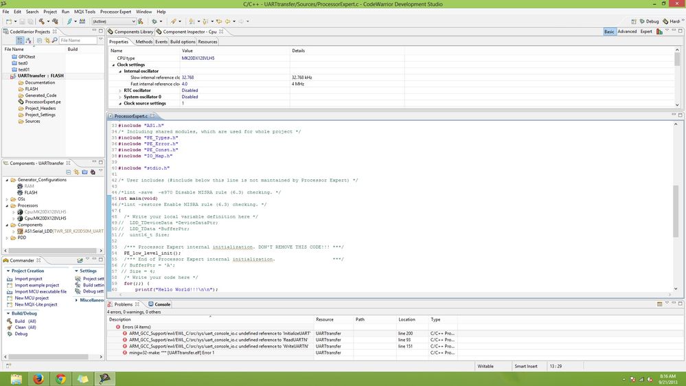

Amit_Kumar1
Senior Contributor II
Hi Miguel
I tried the above statement as you said. but it didn't work I am getting 4 error message which is present in the attached image file. I am using TWR-K20D50M development board from freescle. I am using UART1 with PTE0 and PTE1 connections. as RxD and TXD I am using 38400 baud rate and 48Mhz system clock. I am using Code warrior 10.4 with processor expert integrated with it. How to go to the errors ? By clicking these error meg I am unable to go to the specified line numbers and files.

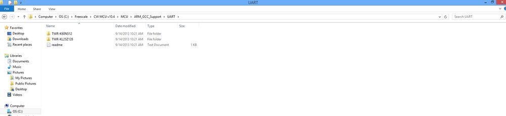

Amit_Kumar1
I was just going through the errors and I found out that there is no folder related to TWR-K20D50M in my code warrior folder which I downloaded from freescale website !!!!!!!!!!!!! and no examples also for this board. this is too irritating Just a waste of time. I think If the board is prepared by freescale so it should have all the examples and code library for that board in the software. In this way all of us who are using TWR-K20D50M board or some similar board whose library is not provided by freescale would be wondering if their code contains problem or there is a problem with the software?? and we all will be having tough time figuring out the same. So what should be my next step for resolving this matter? While installing I installed all the components and they didn't ask for any specific development board.k20.jpgk20(1).jpg
I can see K60 board folder present but not other boards. Is there any problem while Installing Codewarrior due to which this is happening? I am using Codewarrior 10.4 integrated with processor expert.
