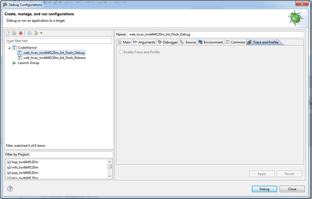

I can use the Tracelink with the K60F demo just fine but when I try to enable it for my TWR-K64 board this is what I get.
I did a file compare on project files for both demos and I can't see any setting that would enable or disable trace and profile.
I was able to program my K64 board using the Tracelink after following the instructions on First Steps with the Freescale TWR-K64F120M | MCU on Eclipse (thanks BlackNight) and another form post here so I know my hardware is OK.
Is there something I'm missing?

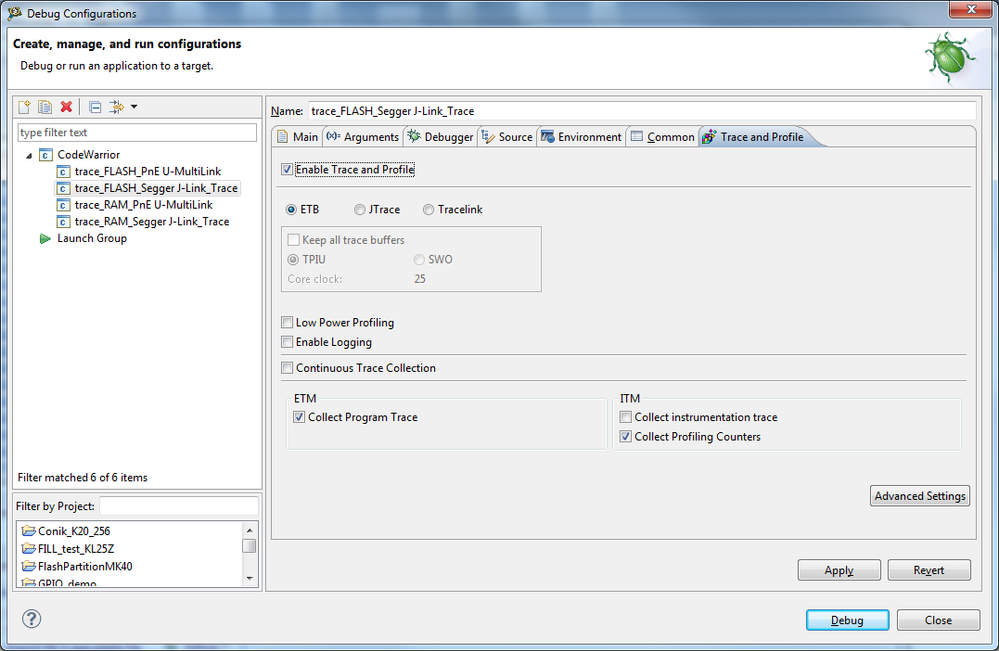

hello William,
I use CW10.6+update3. my debug configuration shows different as yours:
CW10.6:
CodeWarrior for Microcontrollers-Eclipse IDE|Freescale
Freescale has CW10.6 update3 released:
https://community.freescale.com/docs/DOC-103415
this answer is for you, if it helps, please click on "Correct Answer" button. Thanks!

I made a profile specifically for Tracelink as shown in this video provided in this post https://community.freescale.com/message/383956#383956 and the issue persists.
