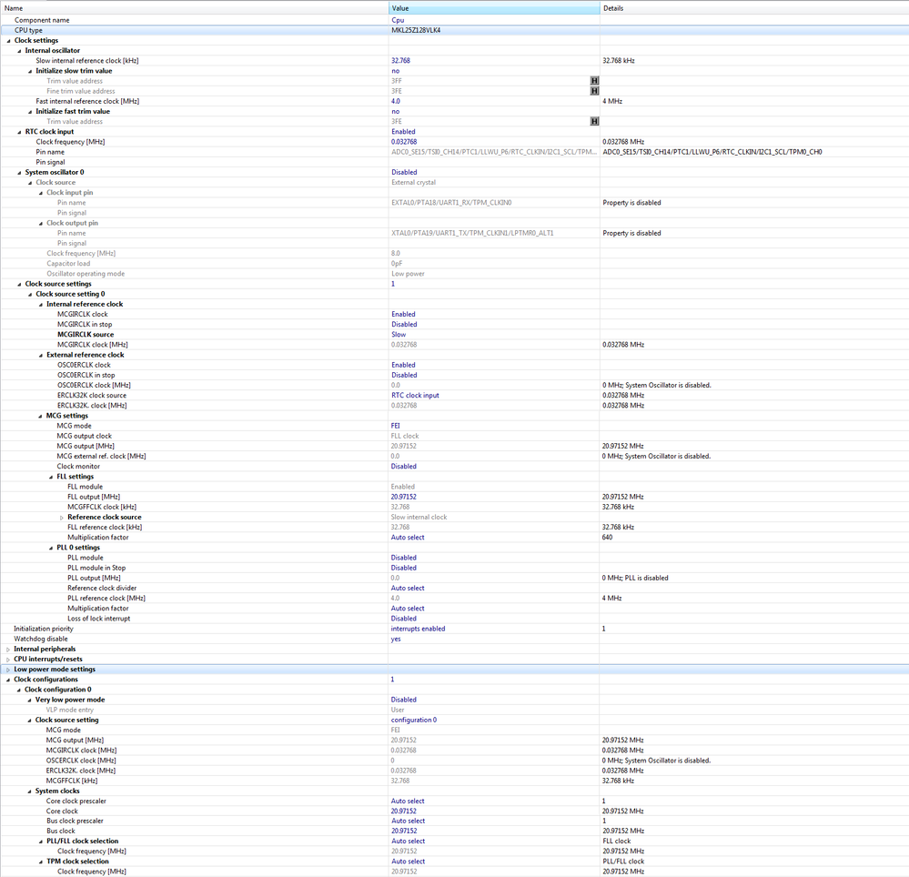

astdom01
I fear you cant and I cant Event find the Settings you wrote - but it sounds interesting! Can you tell me where I find it? Here are my CPU Settings.
Thanks! Dominic

egoodii
Senior Contributor III
I take it from this you have an external 32KHz clock source, NOT the internal oscillator.  In that case, you must insure that the digital input signal spends 'limited' time at any significant voltage 'away from the rails', as like any CMOS input middling voltages incur significant shoot-thru current in the input buffer.  I wouldn't be surprised to see something on the order of 100uA at dead-center (Vbat/2).
