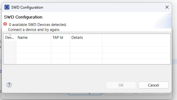

Hello @Pavel_Hernandez
I tried steps which is given in OpenSDA Serial and Debug Application and I successfully upload that cmsis-dap .bin files in bootloader section of my board. But when I reconnect and use MCUXPresso, board is not shown (PFA) as well as board is not came from maintenance board.
After I came into bootloader section that copy files are not shown.

Pavel_Hernandez
Hello, I confirm each board has the same debugger on the board MK20, but could you try with the J-Link driver?
SEGGER - The Embedded Experts - Downloads - J-Link / J-Trace
