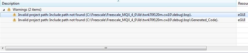

joelesco
Hi Pedro,
First I would like to say thank you for the code example !
I tried to use it but I have an error . I cannot understand how to fix it ! Maybe you could help me !
I look on the path but there just a psp folder and not a bsp :s
Maybe it's a stupid question but ...
I'm looking forward to your reply !
(And sorry for my english ! )
3,249 Views
LuisCasado
Those are only warnings.  Have you build the MQX K70 libraries? You should build the libs witrh the included user_config.h
  #define MQX_USE_LWTIMER            1 is needed for the demo to work.
Copy user_config.h to C:\Freescale\Freescale_MQX_4_0\config\twrk70f120m
Rebuild the MQX libraries
Rebuild the project.
Luis
