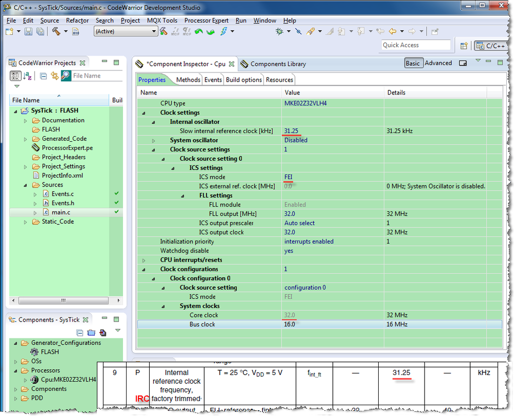

Hello Everyone.
I am using Freescale MKE02Z32xxx4 micro-controller for one of my project, and everything works fine, the complete project is running fine. But my customer reports an issue, that the time taken for executing 10 minute cycle is longer than 10 minutes.
I checked it and found that 1 minute is acting a 1 minute 5 seconds, which means that, something i missed which is causing this behavior.
I am using SysTick to generate 1ms interrupt and using that I am checking timings required ( Example 10 minutes ).
The following is the initialization code.

I am using the the FEI mode.
Can anyone tell me what mistake i had done, and how can I correct it.

Hi Arun,
The default frequency of Slow internal reference clock may error in CodeWarrior10.7 with Processor Expert.
After input 31.25kHz for factory trimmed IRC, we can see the frequency of Core.

Actually I am new to this micro-controller and after using CodeWarrior, I cam to know that the clock is around 16.66MHz and after updating that values, system works properly with correct timings.

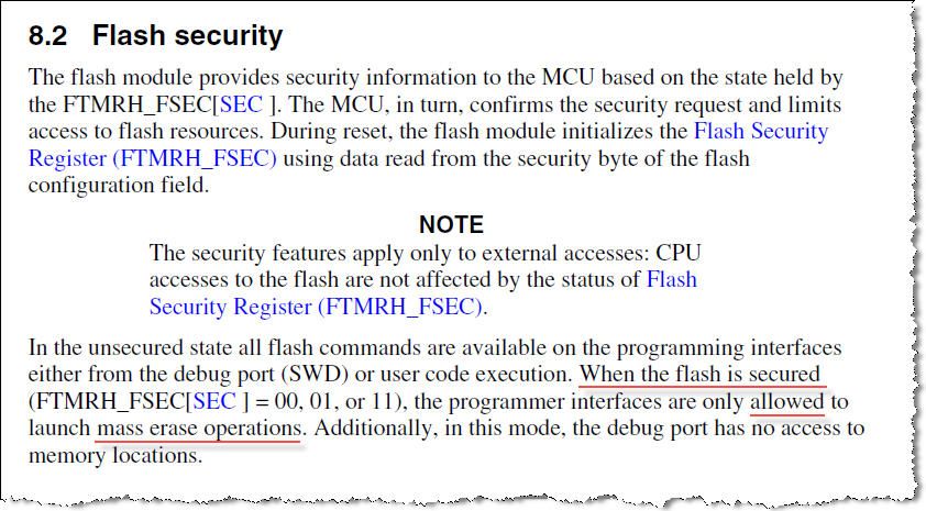

Can you help me in code protection for KE02 series.
I am using IAR and I don't understand how can I protect my code.
It looks like that the Mass Protection is always enabled for this series of micro-controller (MKE02Z32xxx4).
So even if I accidentally secured the flash I can re-flash. Is it right??
I think it's better if I open a new thread for this.
2,604件の閲覧回数
Robin_Shen
You can mass erase the flash and then re-flash it. And please refer the method in 'Flash protection with IAR'.
