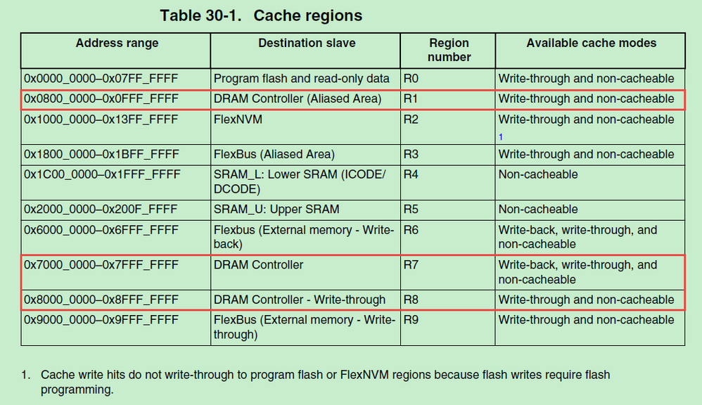

Hi Jim,
The K66 chip provides the cache for SDRAM memory with below setting:
Please check if the cache was enabled at your application.
If yes, you could try to close the cache and check the issue again.
