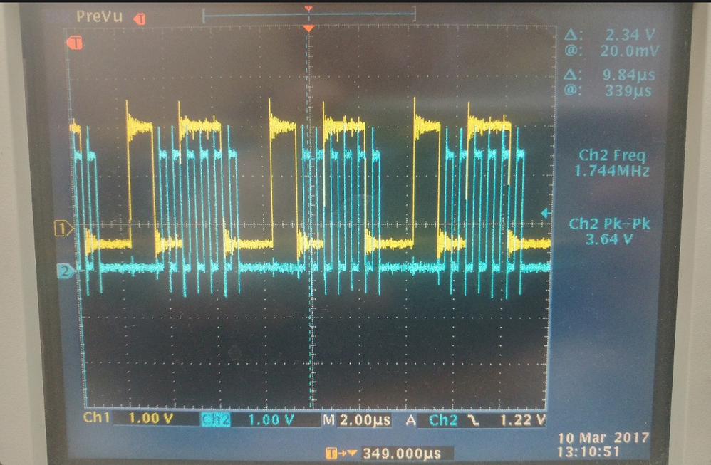

I tested spi interface with maxim device from MKL34Z64.
But I can't understand this issue.
Why that is only six clock of SCK?
Also, I send each 3 bytes, but only the same value is output continuously.
I use driver of fsl_spi.c (SPI_WriteData)
I attached project file.
Would you please let me know why occurred like this situation?
I must need to solve this problem.
thanks.

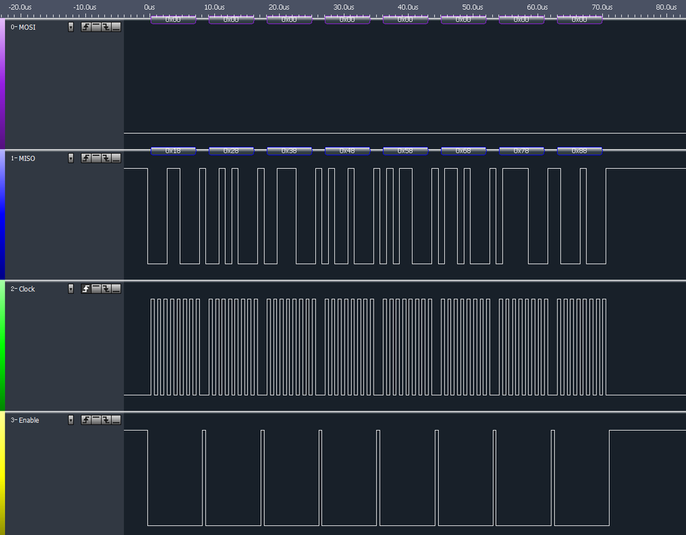

I had tested with FRDM-KL43Z board with SPI1 and FIFO mode enabled.
The KL34 SPI supports up to 8-byte-deep FIFO, so customer could call SPI_WriteData() to transmit data up to 8 times.
While, after customer call SPI_WriteData()  function, it need to polling the SPIx_S[SPTEF] bit to make sure the SPI transmit Buffer(FIFO) empty.
When the SPI FIFO enabled, I could call below code to send 8 bytes out:
    SPI_WriteData(SPI1, 0x18);
    SPI_WriteData(SPI1, 0x28);
    SPI_WriteData(SPI1, 0x38);
    SPI_WriteData(SPI1, 0x48);
    SPI_WriteData(SPI1, 0x58);
    SPI_WriteData(SPI1, 0x68);
    SPI_WriteData(SPI1, 0x78);
    SPI_WriteData(SPI1, 0x88);
    while(!(SPI1->S &  SPI_S_SPTEF_MASK))
I attached my test code for your reference.
When the SPI FIFO enabled, there doesn't need add delay() function between SPI_WriteData() function.
Wish it helps.

jtpark
Dear Hui_Ma,
Thank you for your support.
But I don't want to use an interrupt.
If i use a delay function, Is it ok?
SPI_WriteData(SPI1, (char)0x38);delay(10);
SPI_WriteData(SPI1, (char)0x13);delay(10);
SPI_WriteData(SPI1, (char)0x11);delay(10);
And I still don't understand spi waveform.(spi clk)
Thanks.

Hui_Ma
Wish it helps.
Ma Hui
