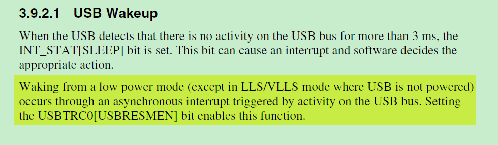

    From the user manual:
When you configure the USB, please enable the USB asynchronous resume interrupt in USBTRC0 register:
 USB0_USBTRC0 |= USB_USBTRC0_USBRESMEN_MASK;
Then enter the stop on your side.
After the stop code, please also take care of the clock mode, if you enter the STOP mode in PEE, after wake up, the clock mode will be in PBE mode, you need to switch mode back to PEE mode.
Please try the configuration on your side, whether it works on your side.
