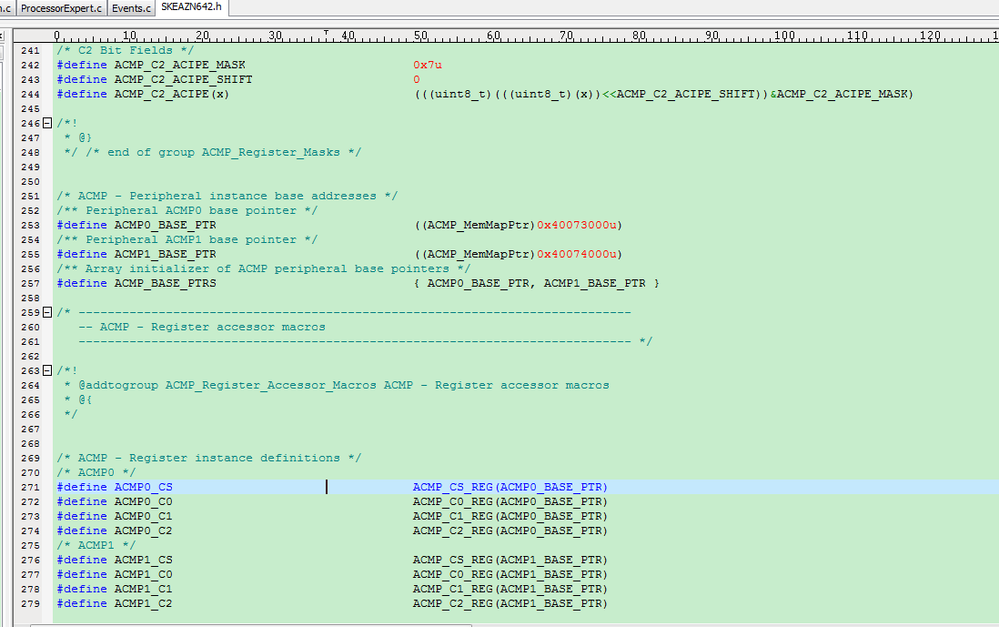

Hi Bahaa Sehsah,
   About the IAR project macros, you totally can refer to the head file definition.
  Please open the IAR path: C:\Program Files (x86)\IAR Systems\Embedded Workbench 8.0\arm\inc\NXP
You can find the SKEAZN642.h.
I post some macros code:
I also attach one head file for your reference.
   Wish it helps you!
Kerry

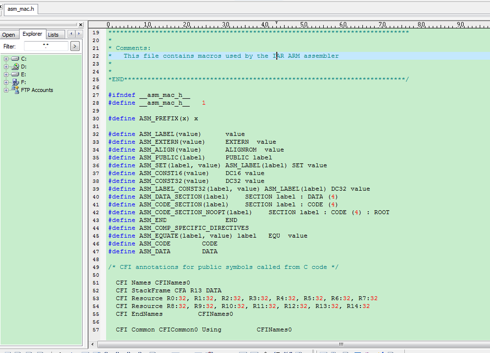

bahaa_sehsah_ex
Hi Kerry,
I need examples for assembly macros not C macros.
Thanks in advance.
3,310 Views
kerryzhou
Hi Bahaa,
   Sorry, my mistake.
You can refer to asm_mac.h which can be find from this path:
C:\Program Files (x86)\IAR Systems\KinetisExample\TWR-K64F120M\mqx\source\psp\cortex_m\compiler\iar
Wish it helps you!
Kerry
